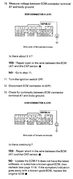

P0336 indicates a problem in the crank position sensor (CKP) circuit. You'll lack spark and fuel when this circuit is not working. Here's how to troubleshoot:

Like Ron said, the CKP times everything. If it is not working, the ECU will assume the engine is not turning and will not inject fuel or fire the spark plugs. It may have been damaged while working on the timing chain, or simply left unplugged.
