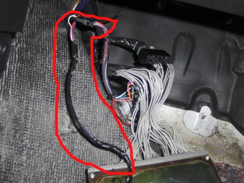

Where does this harness lead to?

I never said a P75 with a VAFC was a "good" choice, just stating it could be done. I only asked about the VAFC because that sure as hell looks like a VAFC/SAFC harness to me and since he does have a P75 it made sense of having a VAFC on top of it.

umm ok well what do u guys think? that harness has 2 wires on the end blue and oj, the other end taps into those wires and then leads thru the firewall.. its dark as hell out ill check tmorrow where it leads in the engine bay, but i have a feeling it goes into the harness..... soo even if i get a new ecu do you think i can just plug it in or do u think the whole car is effed>>?

Before you buy anything we need to sort out this wiring.

yea we really need to know where that wiring harness I circled in that picture goes to. Take as many pics as you can.
