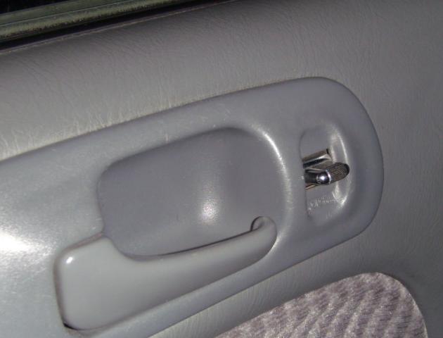

Its a 4 door, ill attach a pic of the auto door locks, altho it looks factory installed.

Old Dec 14, 2008 | 06:35 PM
it's an LX

Old Dec 14, 2008 | 06:47 PM
Originally Posted by f0ok
Yeah HX is a 2dr, but the automatic trans is labeled from top to bottom: P R N D1 D2 2. It doesn't have cruise control. Ill check engine tomorrow for the code G'Night.
No need to check. With that information you just gave me I am 100% sure it's an LX. Your engine is a D16Y7.
