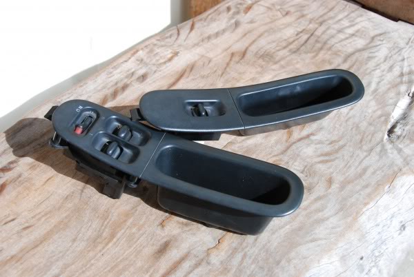

there is a switch that controls the ability to use the windows if it is unpluged or has a short in the wiring then the windows won't work (its the red switch in the pic)
