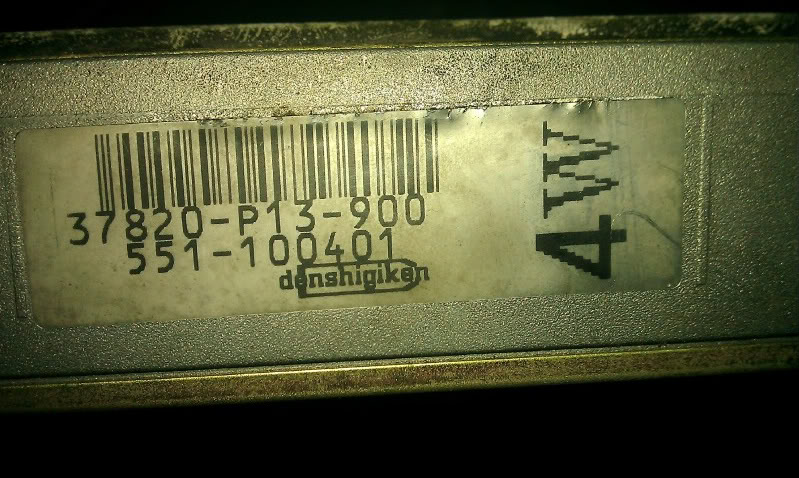

The ecu,
P13 dictates it is from a 93-95 prelude vtec,
I could not figure out which version it is besides that going buy trustdestructions ecu list.
Google search of the full number comes up with that it is Jdm but for an auto.
If that's the case I'll have to figure out if it has been converted for manual
