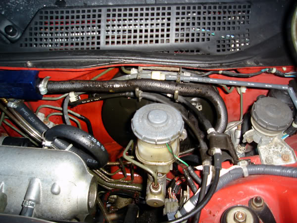

my brake booster line keeps coming off where my intake manifold and the vacuum manifold connects. i have no clue why, it seems like the engine is going to come out of the car. it just doesnt seem secure. i will boost to five pounds and the brake booster line will come off. i have two tight hose clamps on there and usually you dont need hose clamps to keep this line on. please help me with this problem. thank you.

get a slightly smaller hose for a snugger fit

maybe somthing where u cut the line before that "hard part" or after

i dont get it though, it was doing perfectly fine until like two days ago

You talking about that tiny little chunk we had to wedge in there?
If so, go get yourself like a foot of rubber hose, and run a loop like I used to have. I suspect that your motor is rocking a lot of under boost, and thats whats pulling it off.

well now my shifter is being really loose and i think i might have broke one of the engine mounts. im going to go and look at it here in a bit and ill have the full diagnostic on the problem.

bolt came out of the tranny mount, put it back in and its fine now.
