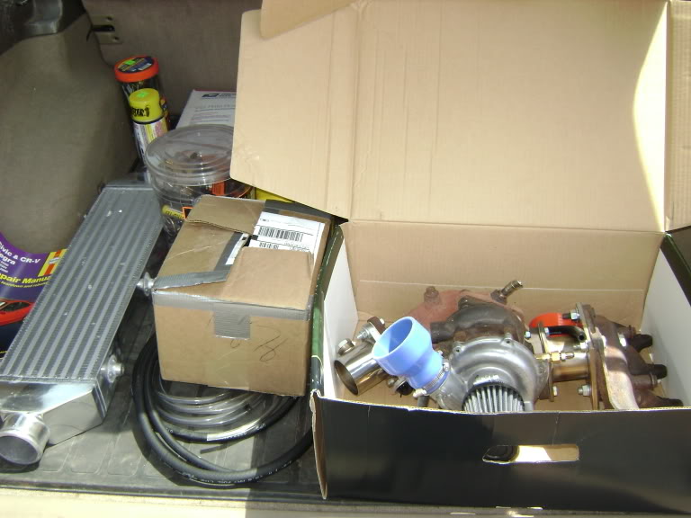

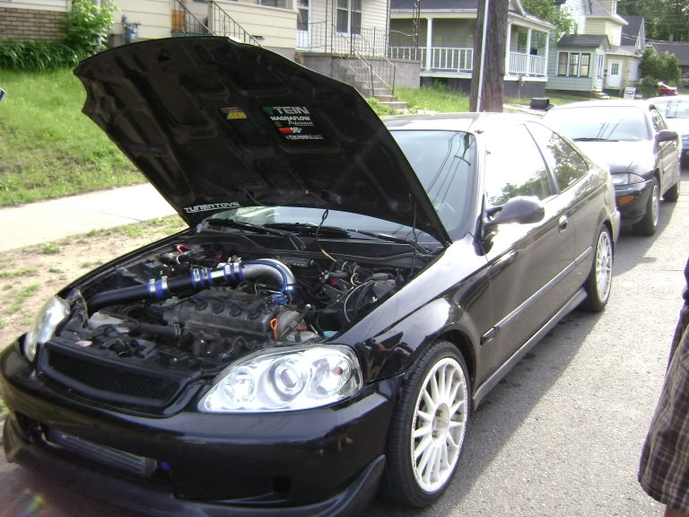

Alright pics are finally here! Enjoy! Yes, my engine bay is dirty, w/e
Secondary mode of transportation (Mom's Suby), packed with parts!

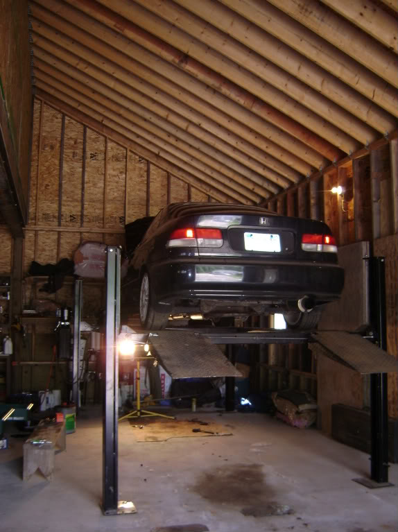

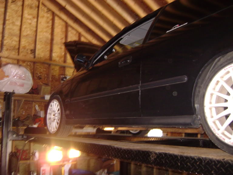

Civ on the lift

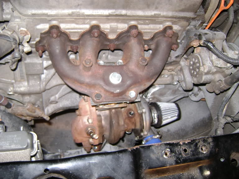

Mani finally bolted on

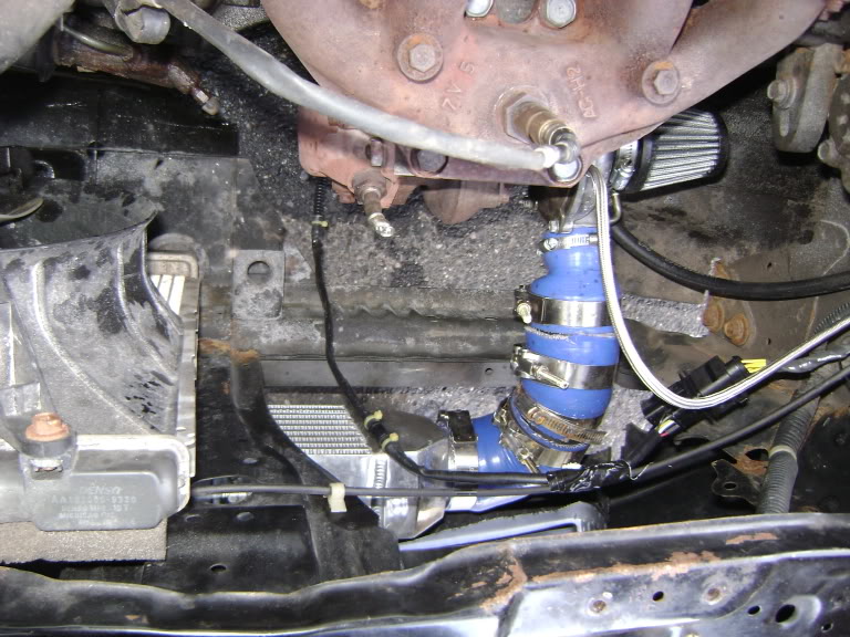

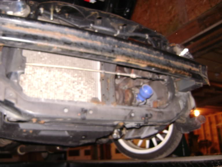

Check the easy access of my charge piping right to my FMIC
All done! Heres the piping ran right to the intercooler (ugh, yea i realize that one coupler is raggity but oh well)

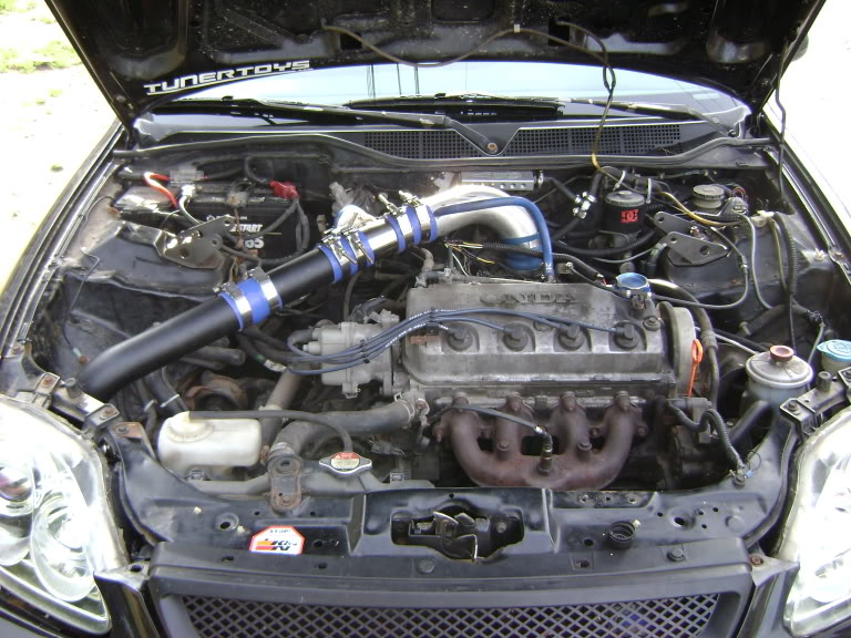

Engine Bay

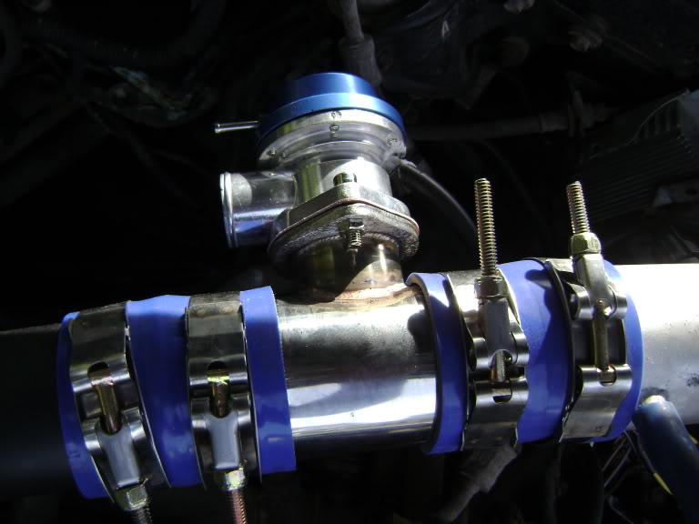

Broken BOV, check the apoxyed nippled [:'(]

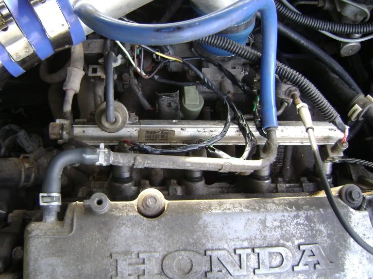

DSM injector's, not TOO ugly, still gonna need some electrical tape/wire cover

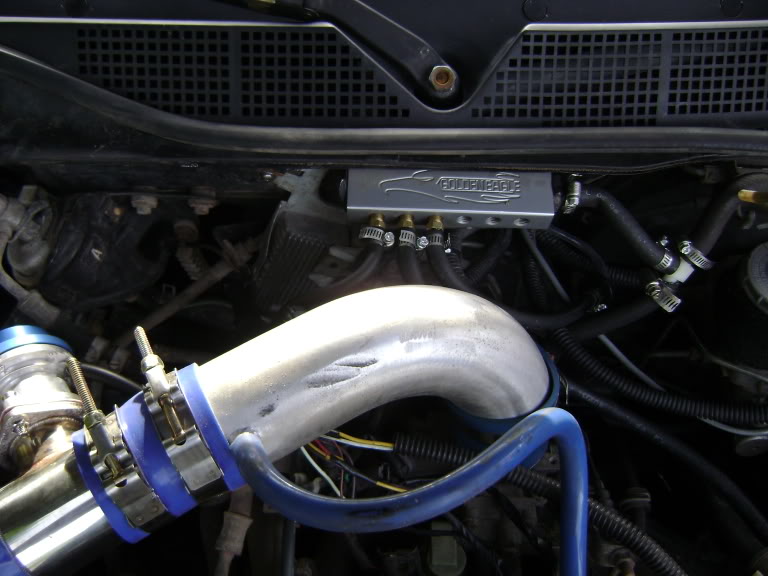

Vacuum manifold/charge piping/BOV, I realize the nipples aren't threaded all the way in but i put some apxoy on there and tightened them down as hard as i could. I'm thining i mighta knicked the threads when i had to drill the manifold old because before they screwd in fine and now they had to be forced really hard to get them in as far as i did

And favorite pic

Default RE: Finally Boosted! Problems of course
Flip, the big blue hose that you have your charge piping connect to the valve cover. GET RID OF IT!!! You want to run the valve cover open to let pressure out, you're pressurizing your crank case by doing that and it will wreck the rings. Just put a plug on the nipple on your charge piping and ziptie it down so that it doesn't go anywhere.
Other than that, looks like you're ready to go.
^ Yeah than just use one of the little breather filters for the valve cover.
^ will do ASAP. I'll put a coupler over the nipple and get a little ventilator for sure.

nice lift....I want one like that

cooool u got ur own lift. congrats on the turbo.

FlipHKD720's Avatar
Posts: 8,442
From: Marquette, MI
thanks. it's actually my friends lift, but it's really nice.
