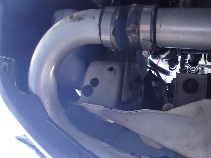

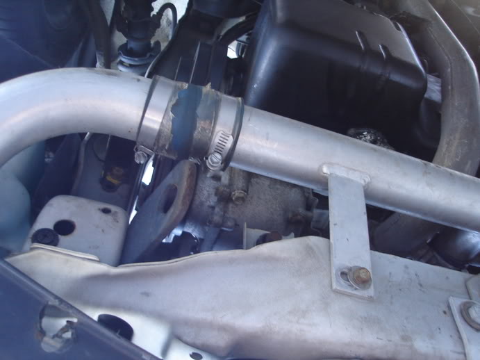

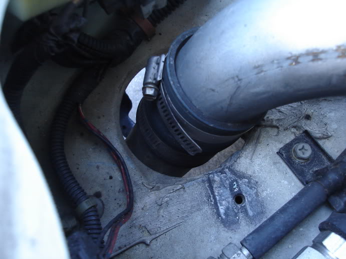

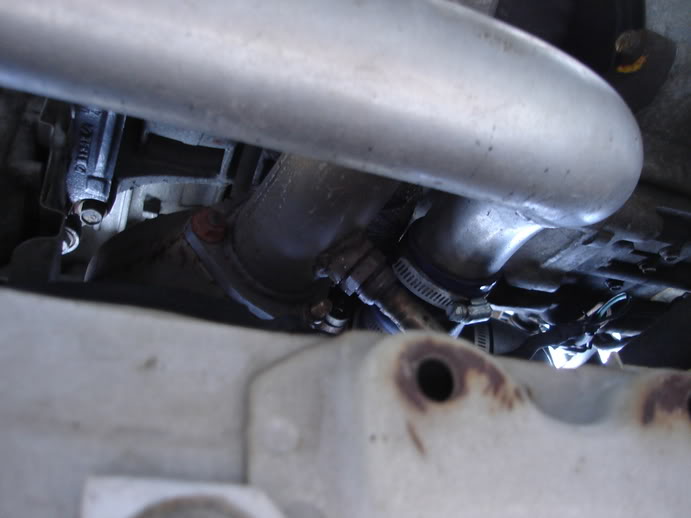

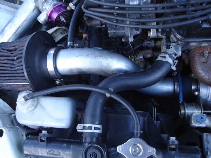

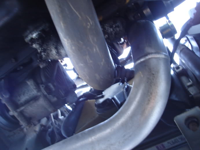

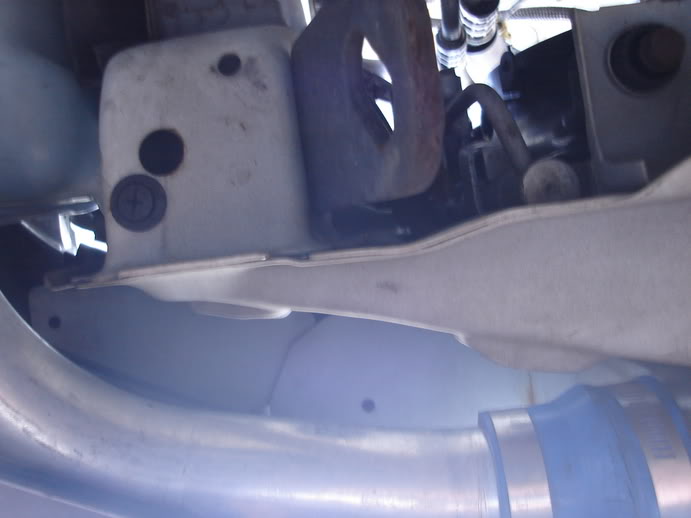

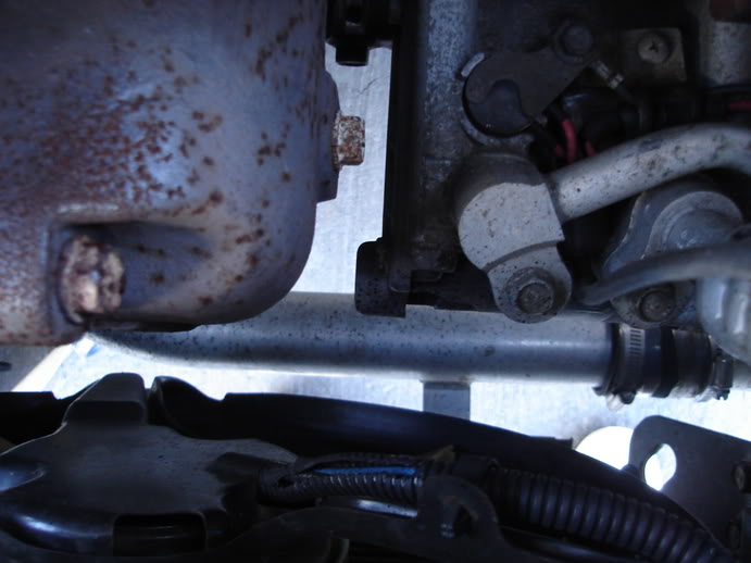

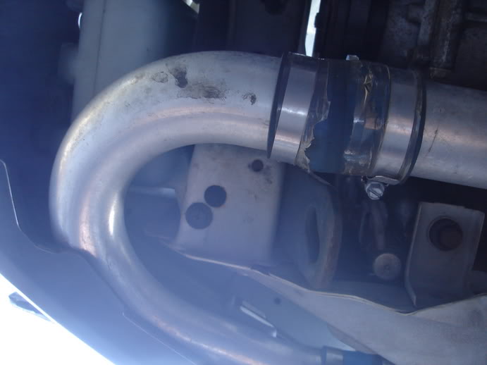

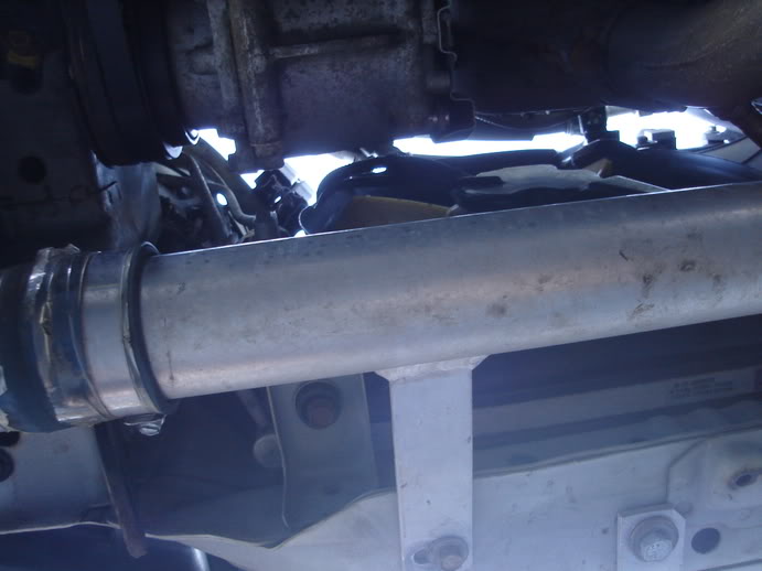

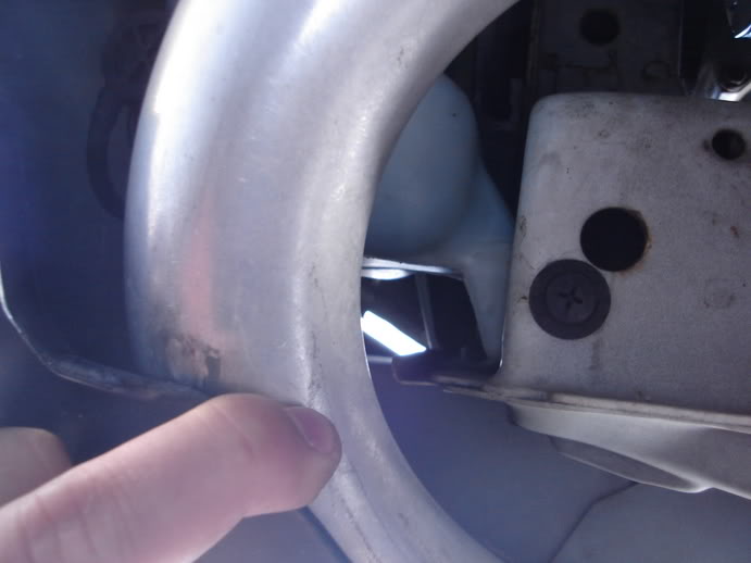

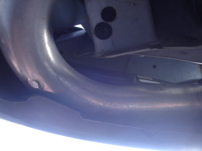

Here are your turbo charge/intercooler pipe pics. Did the best i could.

nice filter.

Good god pete I so told you to get a new filter when I was in thrid grade. Cmon mr money bags, im sure $40 wont kill you at pep boys

Another thought pete, next time your at Napa, pick up some T-bolt clamps. They hold 50 times better then hose clamps, an look much nicer.
Its not as important on a Honda cause of no maf, but I used to blow IC piping off all the time and my car cant get over 5 mph without the IC piping being sealed. sucks on the freeway, lol.
