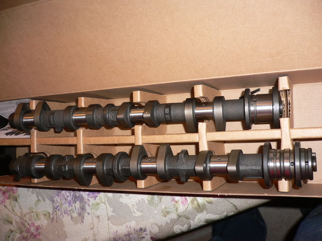

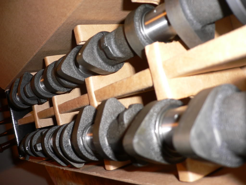

Mine is on my corolla(1.8L DOHC), but they are Crower stage1 cams and im on stock internals so no upgraded springs/retainers. My supercharger is actually an Eaton supercharger rebadged by TRD so it is very similar to the JR supercharger. The JR supercharger will come with everything you need including fuel control. Only thing you might need is colder spark plugs to reduce the chances of spark knock.
If its going to be a daily driver and you want it to be reliable and good on gas then stick with a stage 1 cam. If you plan to try to squeeze every inch of power out of it then get a more aggressive cam but... with that you could possibly need springs/retainers. Each cam has a different profile so its hard to give an exact yes or no.
IMO, stick with a stage1 cam and get a slightly smaller pulley to add a few extra pounds of boost. You'll easily have a 14 second car that is fully reliable and will still get you well over 30MPG. Thats how my Corolla is right now. 10lbs of boost, daily driven, not a single problem and I get about 36MPG highway.
Stage1 cams made a huge difference, night and day.
Here are my cams when I got them:
