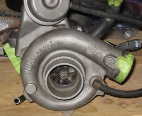

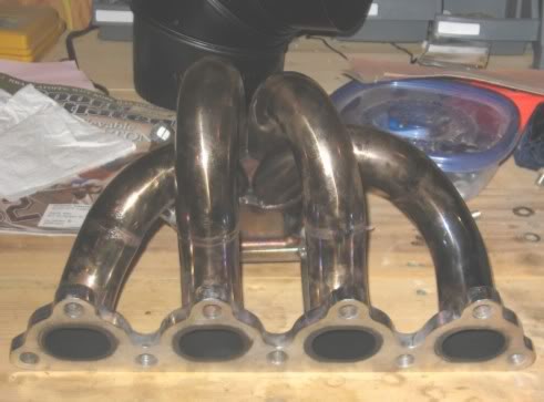

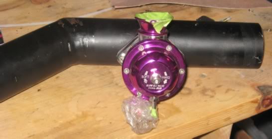

There are a lot of people doing various turbo projects right now. I thought I minus well post my project I got going on. The kit I bought was used on hondaswap.com for $700 including shipping. I still will need some things....
What I have so far: [ol][*]Air Research t3 turbo 42/48 [*] All intercooler piping - and extra [*] t3 turbo manifold - looks like an ebay one, but the guy had it cut and rewelded[*] wastegate block off plate [*] Evo Front mount (fits great)[*] All Couplers[*] Steel Braided Oil Drain[*] Oil Feed (From bushup)[*] Oil Pan, taped and ready to go[*] nock off Rs bov.[*] o2 sensor (he left the o2 sensor in... hey free 02 sensor[8D])
[*]magnaflow hi-flow cat [/ol]
He had it on his car for 15,000 miles 97 civic coupe, so everything should fit perfect. But says the turbo will need to be rebuilt soon but still useable. little bit of white smoke now and then.
Things I need: [ol][*]Greddy emanage ultimate (not tottaly sure... expensive!!!)
[*]larger injectors/resistor box[*]maybe ARP headstuds[*]downpipe - gonna have my mechanic fab one for me, realy good guy wont overcharge me, then heatwrap it[*]gonna try to use filter from my AEM sri[/ol]I'm not in a rush to get this done as their is still a lot I need to research, as well as parts I'm still piecing together and trying to get deals for [8D]. This is a budget setup, and I'm not trying to get a lot of power so you can say that i'm looking for cheap, and reliable of the three[&:]. I'll be happy with 160whp, right now anything is better than what i'm pushing.
Update: Getting ready to buy injectors and resistor box. Instead of buying the popular resistor box from an older Honda. I'm going to buy four 10 watt 10 ohm inline resistors from Radio shack for $5. Also talked to a guy from the place i'm going to get tuned (I get 25% discount on dyno time cause of being a hondatech member), he quoted $850 for Greddy emanage ultimate and plug & play harness [:'(]..... So I'm going to fish around and try to get these myself. Got some pics up finally, not everything tho.

I'm thinking of buying a rebuild kit and rebuilding the turbo myself. For someone whos never done it befor should I just get someone else to do it? It doesn't seem that hard to do. Going by this DIY -> http://www.honda-tech.com/zerothread?id=1397101
How does this rebuild kit look http://cgi.ebay.com/ebaymotors/GARRE...spagenameZWDVW

I dont know much about rebuilding turbos myself. Just so you know you dont have a "t3/t4" you have a straight t3 and a small one thats maybe capable of 250whp tops. I would just run it as is until it starts smoking or something and then send it to a professional that can upgrade housings and wheels or you could just get a new bigger unit eventually.

StifflersMom's Avatar
Cat Fuсker
Joined: Nov 1978
Posts: 7,036
From: The Moon
Default RE: Yet another turbo project
If you are going to rebuild it yourself - PM me. I've got a guy that balances pretty darn well.

ORIGINAL: red2000Si
Thats what i'm looking for just shooting for around 170-180whp. Oh, I know the turbo is from a Mitsubishi and isn't that big but thats fine for me. Thanks for the correction tho, damn't my noobnish is showing! lol
One thing tho is that in my state I can't convert back to obd1 and I was talking to a tuner around my area and says that a greddy emanage would be fine... I guess I don't really have a choice tho[&:]. He told me that he can tune them very reliably and not to worry.

If it's a TD04 than it's a rather easy rebuild...
