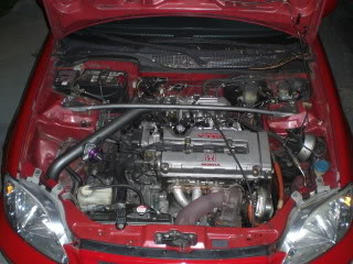

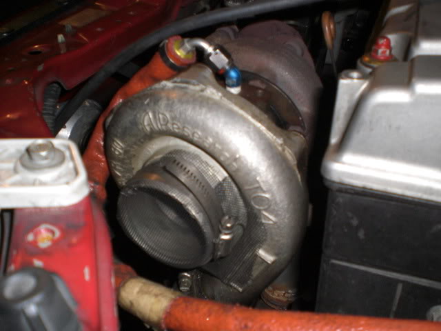

Let's start off with the dirty engine bay pic. We had a near hurricane yesterday which explains all the debris everywhere. Btw thanks to dfdon for the turbo. 6 months of boost with nothing but a screen filter and still spooling up like a champ.

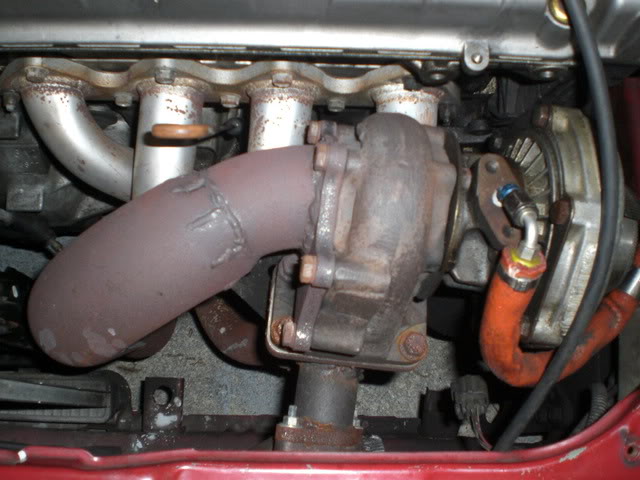

Solid custom 2.5-3" downpipe action.

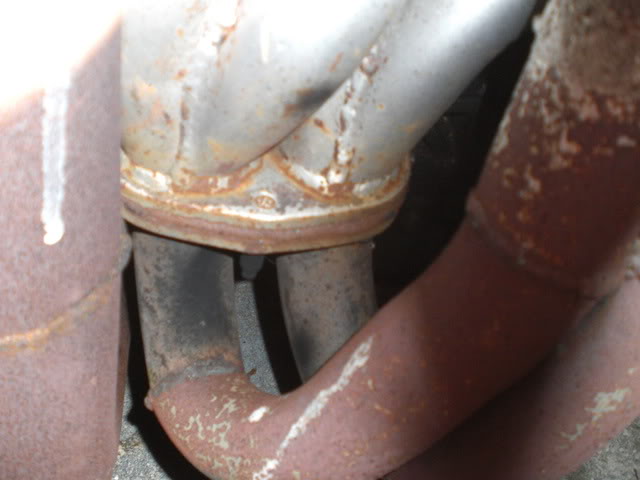

This is the collector off the old header that we welded 2 90* bends off both openings to create a 180* bend back up to form the top mount. \/
We also made a full 3" exhaust with nothing but a high flowing 3" resonator which sounds amazing. Ive had a a few small hairline cracks in this manifold over the past six months but nothing too serious. Its been pretty durable for what it is. Also a really slow oil leak out the feed fitting in the block and out of the return fitting on the bottom of the turbo but im not losing any noticeable oil even after 2 months between oil changes. Overall I think this setup is pretty cool and Im definitely proud of the fab work. Making the manifold, downpipe and exhaust was a ton of fun and I think it looks really unique. Im thinking of going back to a cast log manifold soon for a little quicker spool and overall a little simpler setup but not exactly sure what direction and when. Hope you guys enjoy this as much as I have.

Hey, on the ID tag on the compressor housing of that turbo does it say "Model Number T0457"?

Lol thats my sweet airplane oil line. No those #'s arent on it anywhere. Btw the turbo is a t3/to4b v-trim .48/.60. I wasnt planning on using the screen for very long but it hasnt caused any problems at all so its still there. I will be buying a new intercooler pretty soon since the one Im using now is pretty bent up. It holds boost just fine and seems to work perfectly but it looks a little goofy behind the bumber and Im not sure it will flow a whole lot more than 10 psi/250whp anyway. My radiator fan hasnt been working lately which isnt good so I tested it by running power to it straight from the battery, the fan itself is perfectly fine so it must be something wierd. Any suggestions on that would be great. I'll also probably be getting a new ebay alluminum radiator soon.
