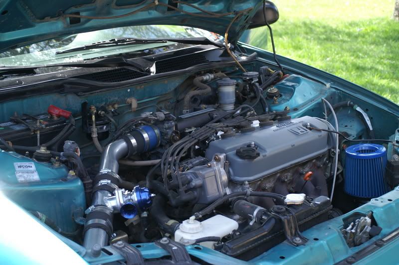

This is my budget build.
1. 1993 civic dx hatch, d15b7 146000 miles
2. t25 from 2nd gen eclipse water cooled and internal wastegate, Hf manifold, adapter plate, downpipe with unknown size(lol) all for $125, homemade chargepipe $80, Cheap couplers and clamps $40, Tuner toys oil line hit $90, Walbro 255 fuel pump $100, Greddy knock off bov $60, RC 310cc injectors $100, Greddy E-manage basic unit $300, Blox map sensor bypass $60, Autometer boost guage $60, Misc. Gaskets/bolt.etc $40
3. Total cost =1055. ( I know I'm missing something cause I think I spent around 1200)
4. Mainly ebay and tunertoys.com
5. Greddy emanage would be worth it if you buy all the harnesses and the datalink cable, but it pretty cheap to buy used so its great for a budget build till you can get a tune.
6. No idea power wise.
7. Buy good clamps. I've broke quite a few.
8. Well every problem I had I didn't think I would, Fuel pump couldn't put out enough and the map sensor bypass is a must. Stock clutch won't hold so I reccomend something alittel better
9. Make sure you have every part ready to install. A fuel pump is a must. Walbro are so cheap so its worth it. Jb weld on the oil return doesn't work, get it welded. Research, ask questions, talk to people who have done it before, talk to the right people(be careful of some shops especially ones that tell you buying a kit from them is better.) I've never turboed a car before so I went into this to try it out and see if I like it. Don't go cheap with engine management. If you are serious about it do it right.
Good idea pics.

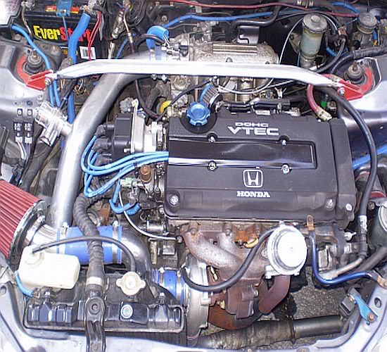

Everything from parts to labor to tune cost me 4000.00
Complete Drag Turbo Kit:
-Drag High flow 4 into 1 cast iron turbo exhaust manifold (lifetime warranty)
- Master power hybrid to4e/t3 turbo (1 year warranty)
- Tial 38mm wategate .5 bar w/ dumptube
- Drag High Flow front mount intercooler w/ polished cast aluminum end tanks
- Blitz blow-off valve
- Drag mandrel bent high flowpowercoated silverpipes
- Drag mandrel bent high flow exhaust down pipe
- Drag wastegate dump tube assembly
- Drag Blue silicone hose and hose clamps
- Drag 255 High pressure/High volume inline fuel pump
- Intake air filter assembly
- Map sensor bypass valves
- Stainless steel braided oil feed line w/ fittings
- Oil return assembly
- All necessary hardware and fittings
- All necessary hose and hose clamps
- All necessary gaskets
-Autometer boost and oil pressure gauges
-ACT XTSS clutch
-RC Injectors 440cc
-Chipped PR-3
-Tuned at 6psi. on Crome
Power: 220whp 171wtq. (This with 35% leakdown in cylinders #1 and #2) THIS IS A PRIME EXAMPLE TO HAVE A COMPRESSION + LEAKDOWN TEST BEFORE YOU BOOST. I DEFINITELY WOULD BE PUTTING OUT MORE HORSEPOWER IF MY MOTOR WAS IN BETTER CONDITION.
