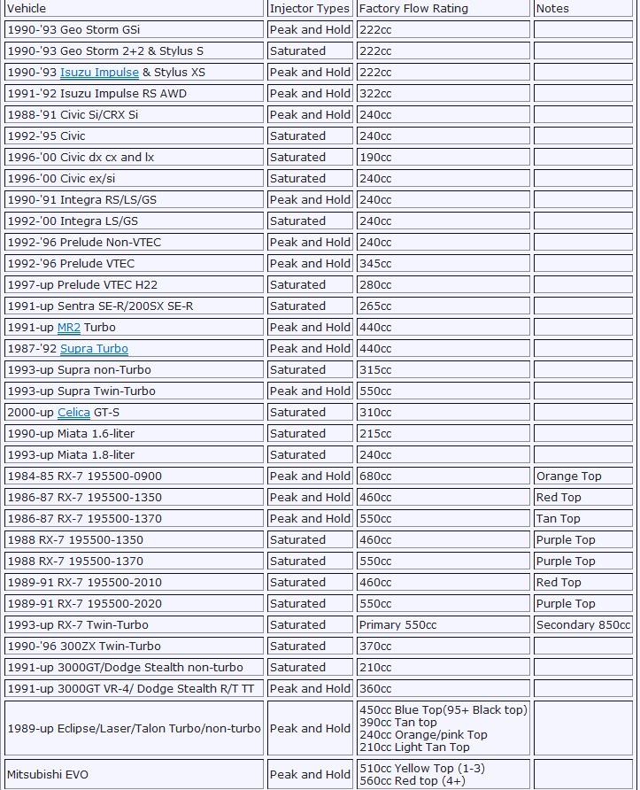

Will all these fit on the civic? I know the dsm injectors need a bit of modding to fit.

lol you really should just go to hondamarketplace.com and look
look, RC 310cc injectors for $165 shipped

Anyone know what size my stock Hx injectors are? Just so I know where my stock fuel system stands.
Old Mar 12, 2009 | 10:19 PM
  #25
240cc

Really I thouht they would be smaller than that. Its the y5 motor that is tuned for high gas mileage.
Old Mar 12, 2009 | 10:34 PM
  #27
Pretty sure they're the same injectors, and the lean burn attributes of the motor are controlled by the ECU.

Ok cool I was thinking the y5 might have 190cc injectors like the y7(at least I think the y7 has 190cc). I am in better shape fuel delievery wise than I thought. What is a good fast spooling turbo? Would a T25 or a T3/T4 be better? I want to have an internal waste gated turbo and was think a .50 would be good. Any suggestions please????
Old Mar 13, 2009 | 04:21 PM
  #29
Oh, i'm sorry. It probably has 190cc. lol
