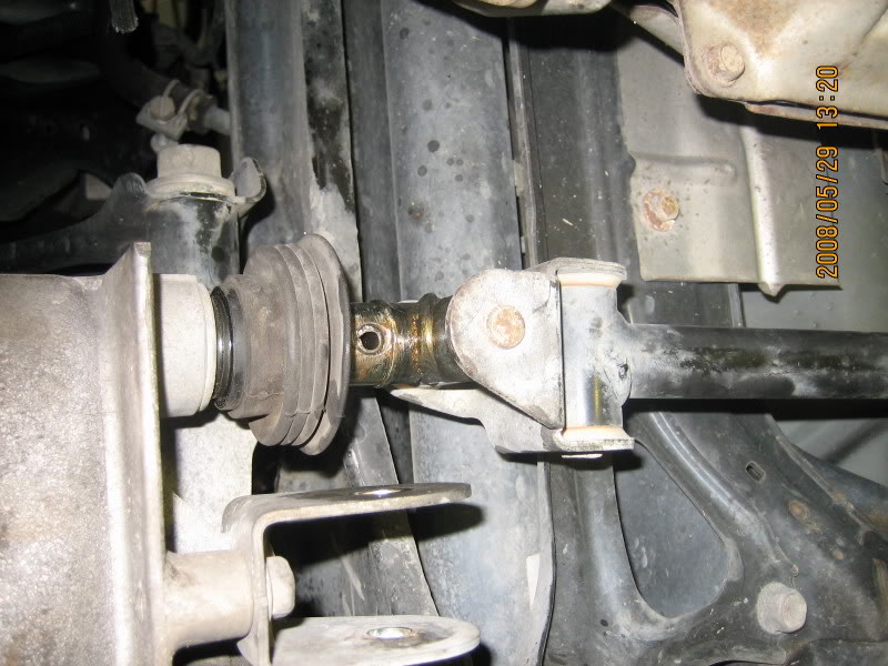

half shafts removed, tranny fluid drained. Btw, anyone having trouble with the ball joint, there's an awesome trick that makes them really easy to do.

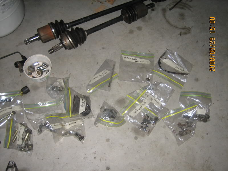

i decided to leave everything organized so i'm not missing nuts and bolts later...

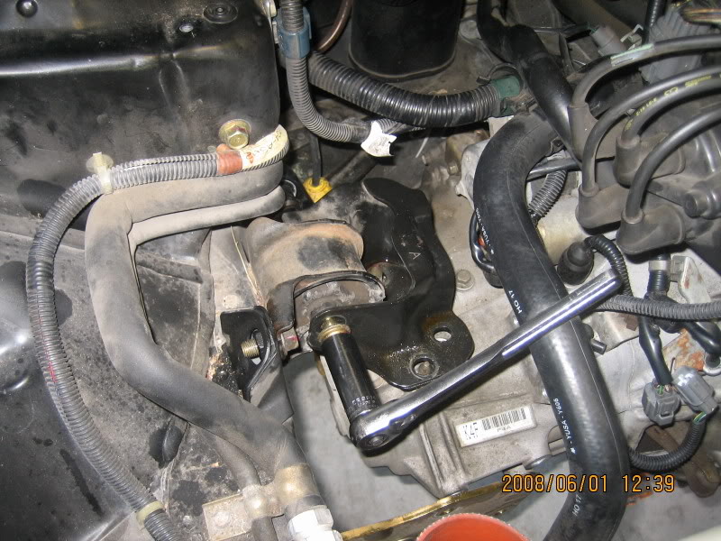

undoing the last support for the trans, the tranny mount.

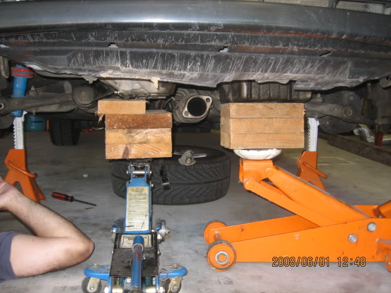

Supporting the engine and trans, about to slide the trans off the block.

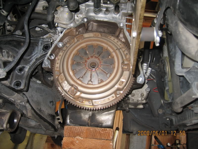

The old clutch plate

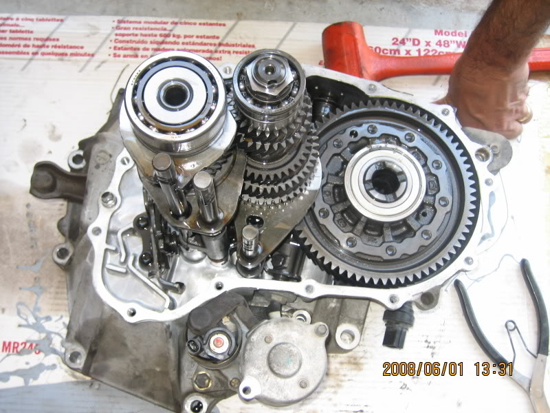

Inside of tranny

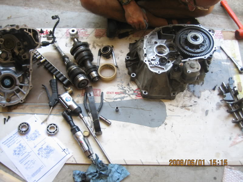

my work space, with helms and bearings in the lower left corner

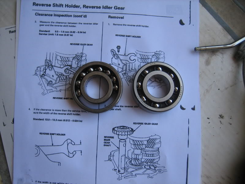

this pictures is actually pretty cool...the source of all my problems is that little bearing. the plastic spacer that holds the ***** equidistant had shattered and i found remnants in my tranny. You can see how all the little ***** are on the same side-definitely not good. It rattles when you spin it. You can see the new one on the right. I also replaced the throwout bearing cuz you might as well when you already have the tranny off.

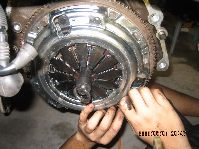

This is the new pressure plate with the new clutch inside and the clutch alligning tool in there. I'm screwing in the new bolts on the housing.
