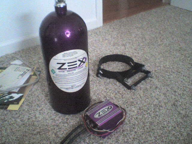

I am ordering most of this stuff today and yesterday my dry nitrous kit got here which is the only thing I have pictures of at the moment. More pictures are comming in as soon as the parts do and when I install them.

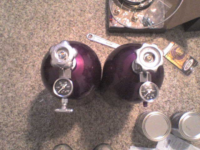

Maximizer kit came yesterday

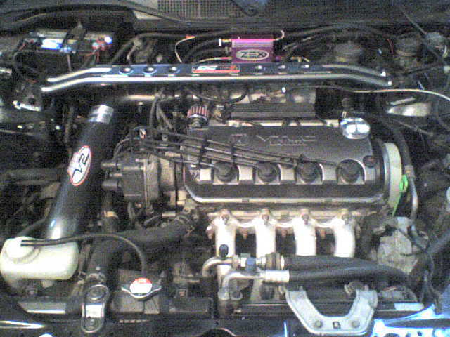

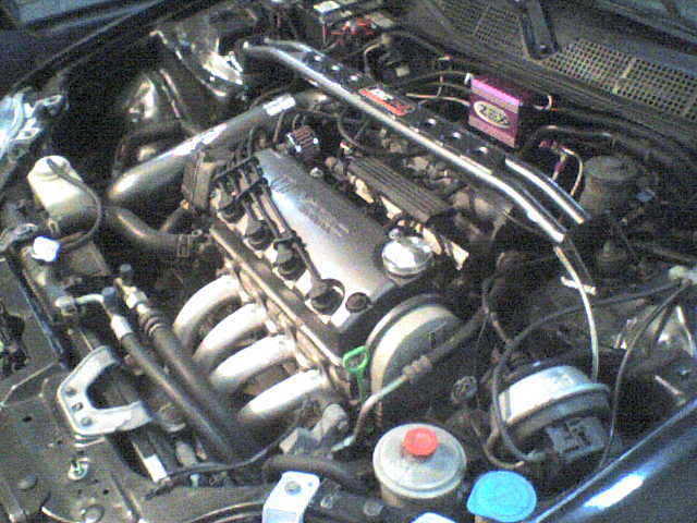

I finished installing the whole basic system so far. I was nervous as hell drilling into my $300 intake... lol

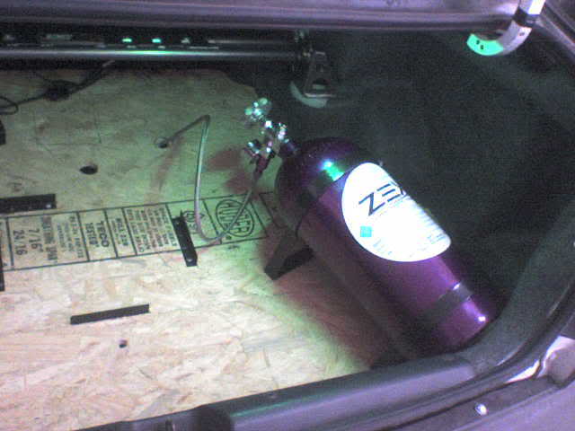

My unfinished trunk:

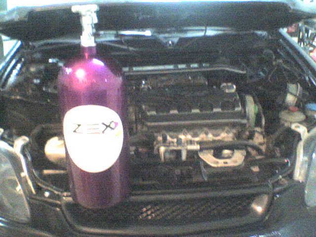

I just like this picture:

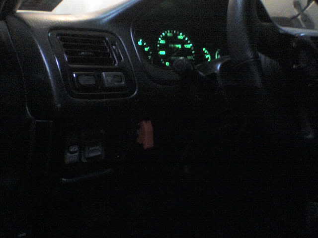

Picture of my nawz button and my cluster from addiction's DIY:

green cluster
just looks like ya should have TWEAKED it a little... or maybe its just the angle the 7RPM doesn't look lite...
tho the cop picture is amusing.....
so wheres the PURGE lines? ya know ya need some green lights on it to match [8D]
looks good under the hood. tho IMO i think it would realy pop if ya polished those raised lettering on the valve cover...
