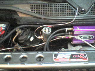

Anyway back on track, I spent my last $800 on gauges and a speeding ticket so I am building my setup from paycheck to paycheck now.
I will post pictures of the gauges tomorrow (Autometer Cobalt Fuel pressure, nitrous pressure, and AEM UGEO Wide band)
I got the right fitting sent to me for the purge kit and installed it today, I would have a video of purging to show you guys but I don't have any nitrous yet.

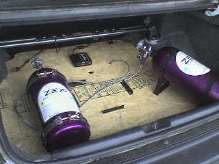

Maximizer kit installed:
The bottle on the right is the old style which is why it is mounted different, I am going to buy the new style brackets and mount it like the bottle on the left so it is symmetrical. (I'm a perfectionist)

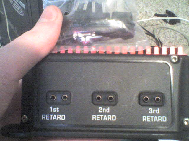

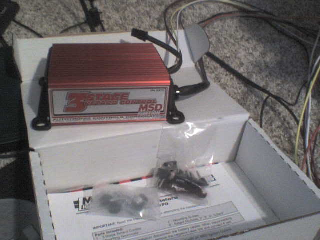

MSD Timing Controller:
I am going to have to wait until the rest of my msd ignition stuff gets here before I can install this.
They do also make this extremely easy too, it comes with an assortment of pills so you just have to plug in the ones you want and you can swap them quick.
This can be mounted in the engine bay but it is still fairly large so I don't know where to put it yet.
