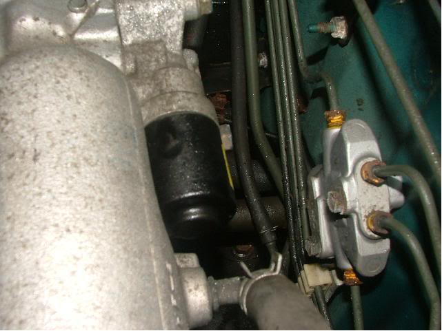

First, locate the IACV. It's in the back of the engine bay by the intake manifold and throttle body. I have circled it below (should be located here for most, if not all, D and B series).

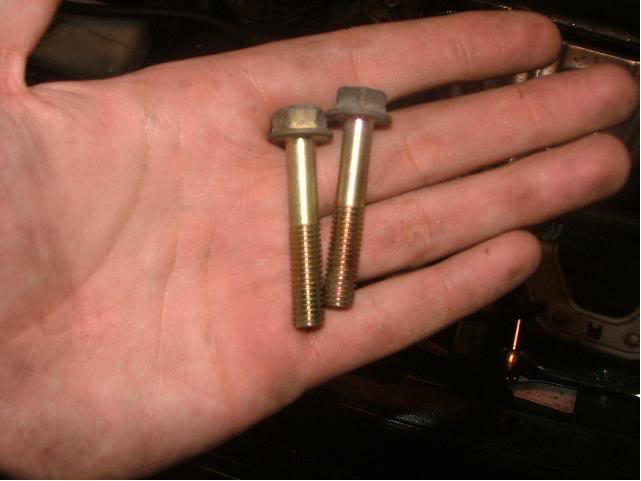

The next step is to loosen the two 12mm bolts that hold it on.

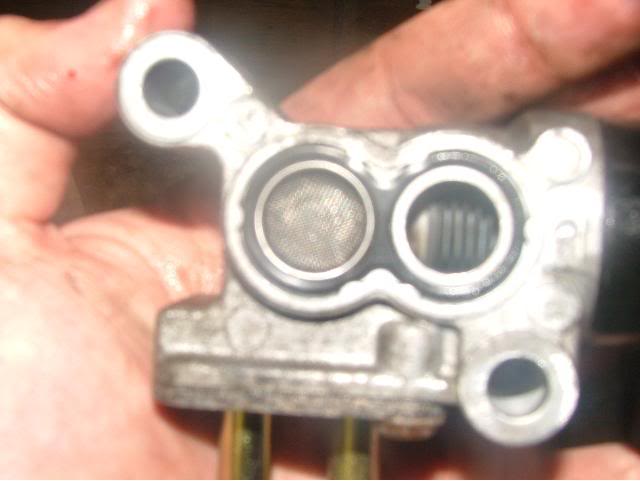

As you can see, my screen is a tad bit clogged up. Take the brake or carb cleaner and spray it on the screen. Leave sufficient time for this to dry before reinstalling it. You should have something like this.
