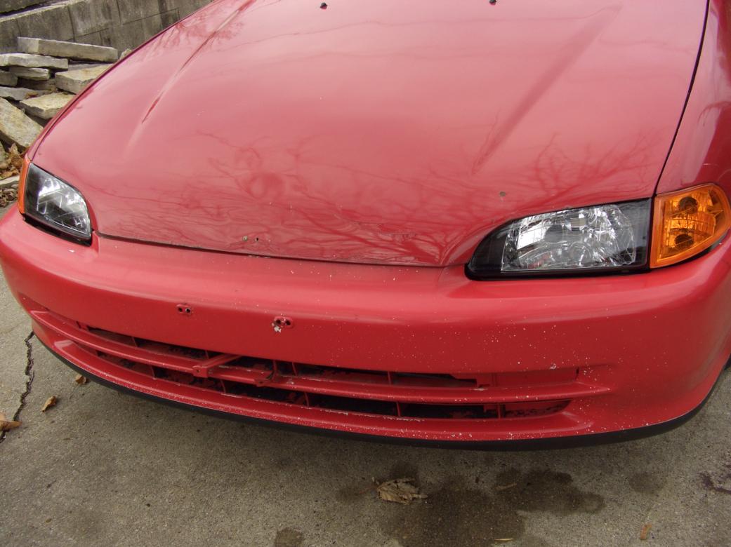

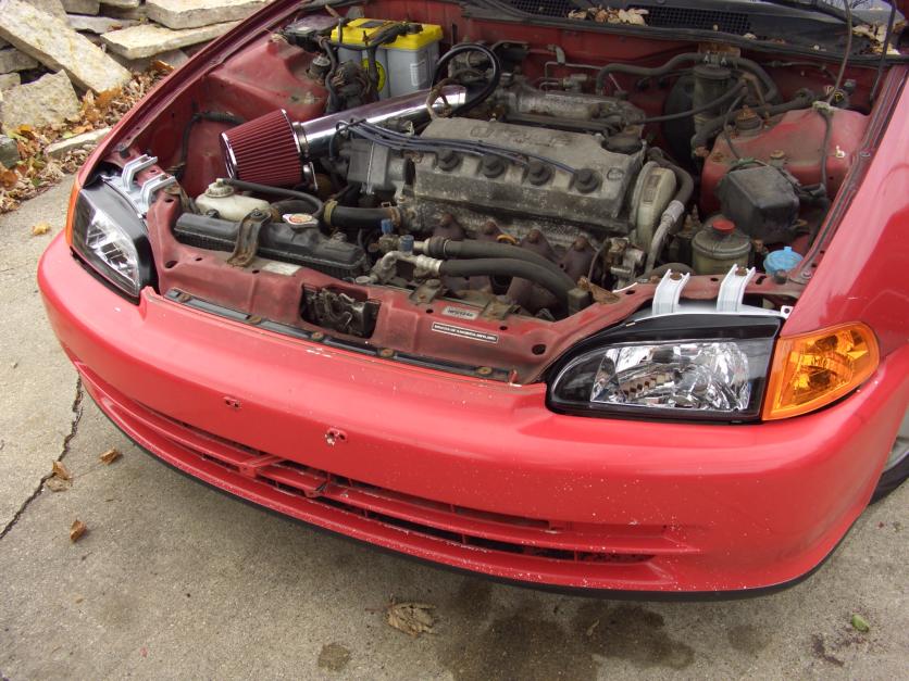

so i finaly got my new headlights!! and just installed them in this freeeezing weather. i guess the previous owner had several ppl back into it and kinda messed up the front end. the bumper doesn't fit very well and the hood is all kinds of effed. but the old broken headlights are out and the new ones look so much better!! ill adjust them tonight. installed some luminics ultra white, and the blue coating looks awesome when their off.

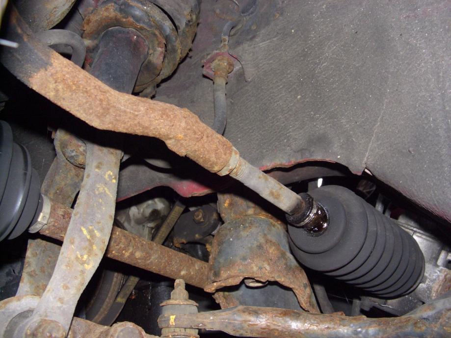

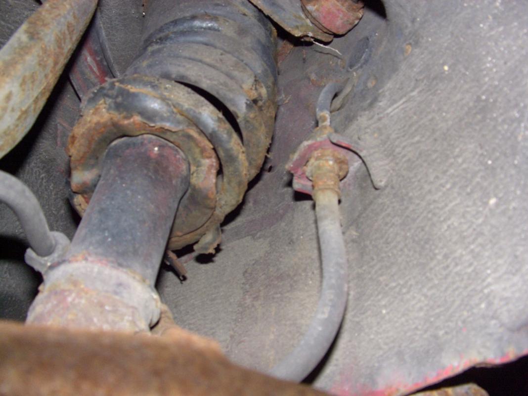

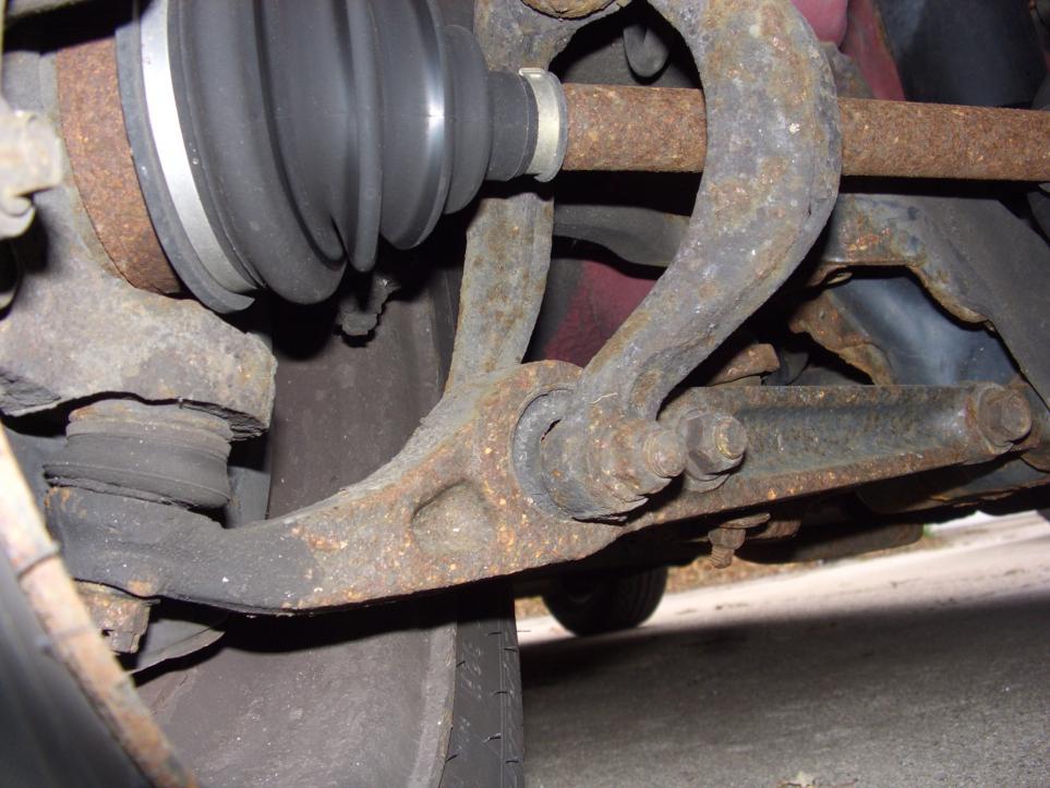

while i was out there i took some pics of the front sus. it doesn't look good i figure out what the squeaking was. it looks like the bottom rest on the damper for the spring is rusted pretty bad and the spring is all crooked (see pic)
and the bushings are shot, good thing i plan on replacing them.
bolts look rusted to hell. ugh this doesnt look like its gonna be easy

headlights look great
And honestly, you'd be surprised at how easy the front bolts usually come off. They usually look pretty rusted, but they don't (usually) give you much trouble coming off. It's the rears you have to look out for since the front wheels kick up water and salt (if you live in a climate with snow) on the rear suspension.

and ya definatly replace that spring at least... but chances are the strut might be bent also.... also replace that lower strut bushing... it looks like its torn loose, might just be the angle but it looks seperated from the rubber and shaft.
and the inner tie rod boot i dont believe makes any noise... my old 94 had both bad and it didnt make a noise at all.
id say most of your issues are from that strut and spring and LCA/strut bushing.
