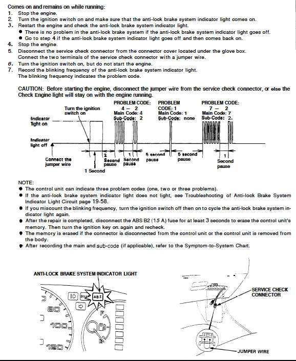

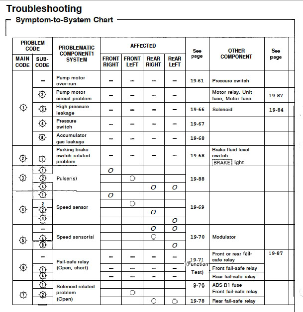

ABS light stays on. I can slam on the brakes an they lock up. Is there a common problem with this? 92 ex.
Old Aug 2, 2008 | 09:16 PM
Retrieve the ABS trouble code and then go from there:
