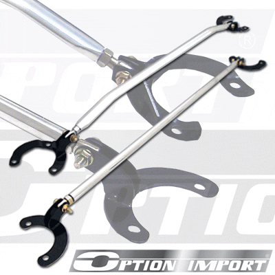

you can also lower car it helps cornering but if you lower get a camber kit also.
add front and rear strut bars they make a difference in handling around corners
like this and they are very easy to install

No, you do not need to lower the car to get a little better performance out of your suspension. Although, it can sometimes be the cheapest way to do it. If you want to retain your stock ride height but want to corner a little faster, I'd suggest strut bars like 94civichatchback has shown. They are cheap, $20-$100 on ebay, and usually make a slight, but noticeable difference. Another thing would be sway bars. Front and rear kits can go for about $300. Easy to install and make a good noticeable difference in handling without sacrificing ride quality or height. I've never heard of sway bars causing "hop" while cornering like conceptualpolymer said, nor have I ever experience it and I've dealt with sway bars on different cars with difference setups under street/race conditions. Hell, many cars come stock with front/rear sway bars from the factory... Any hop would probably be from bad tires or the over dampened shocks. Speaking of tires, one of the best things to get to improve handling is some sticky rubber. There are some good all-seasons that grip well, the best would be a summer tire but depending on where you live you may not want that(snow, heavy rain..).
