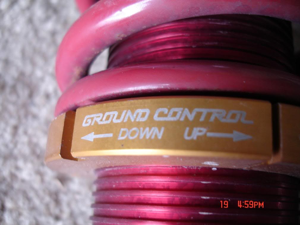

well basicaly wondering if anyone knows what kinda stuff i just got....
found these localy for sale. from a EG civic but i plan on instaling these on my 99civic.

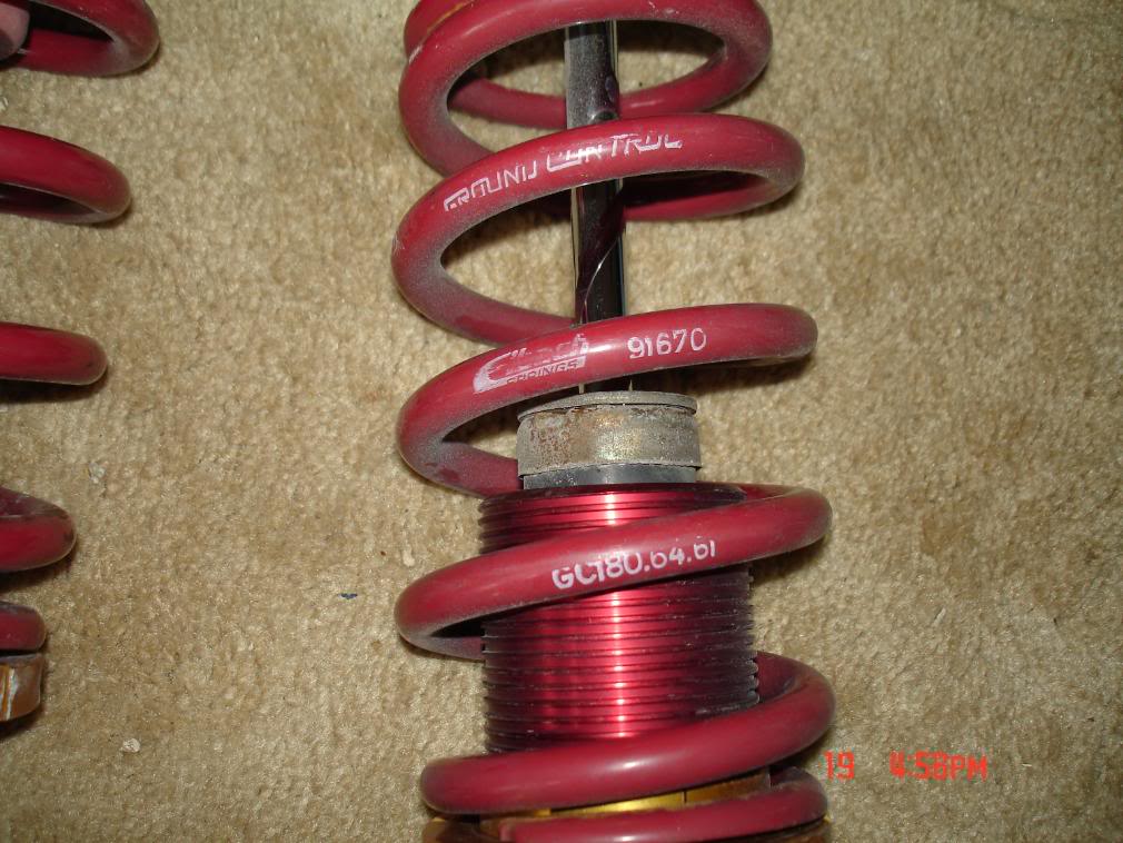

mainly 2 problems one.... not sure which spring goes in front or rear.... the guy has them on different struts. i figure he didnt know which springs where for which and screwed up the instal bad.LOL might be why i got them so cheap MAYBE... he said he bought them from oreillys 1 month ago. im thinking he had the soft springs on one side of the car front and back and stiff on the oposite side.LOL
just not sure which spring goes where, and second not sure what spring rate these are set at.... curious to find out if they are supper stiff or a daily driving style...

44 = 250#
61 = 350#
those are standard rates, pretty soft, the stiffer ones are supposed to go in the front (higher number)

180.64.44 = 7" height x 2.5"diameterx 250 lbs/ft
180.64.61 = 7" height x 2.5" diameter x 350 lbs/ft
those springs are fine for daily. to adjust, just need the right size allen key, loosen the spring perch a bit, and adjust. very easy and fast to do. Koni yellows are externally rebound adjustable.
