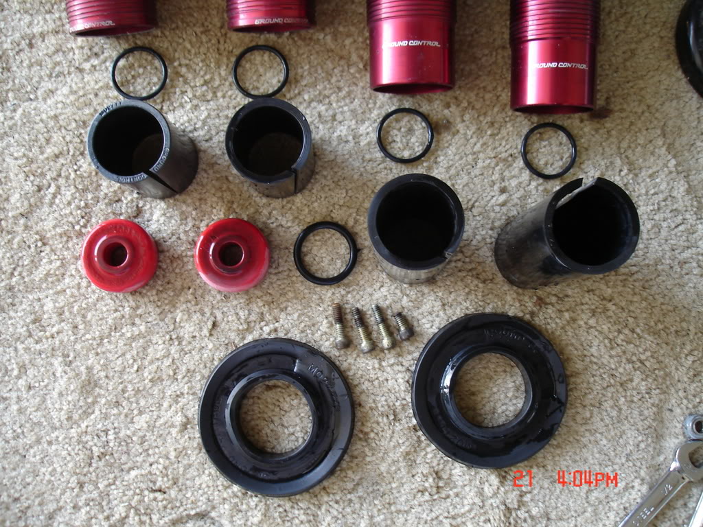

DOES ANYONE KNOW HOW TO INSTAL THESE COILOVERS?
ive seen the DIY with regular coilovers forum... BUT what confuses me is the thick rubber sleeve GCs come with i guess...
these LARGE rubber sleeves.

when i pulled them off the stock struts i got them on i only found like 1 Oring per strut. the DIY says use 2 per strut. JUST CURIOUS..... i really dont want to instal these wrong... i cannt find any instructions on GCs website...
i understand the rest... adjusting them/locking them. just not sure of geting the sleeves on them..
i do know that when i got the coilovers the sleeves were not tight at all. the rear ones seemed to be tight but not the front sleeves. BUT seeing how the kid before me screwed up with the spring placement im sure he didnt instal them correctly.LOL
which is why im at least smart enough to ask questions.

The o-rings are for certain brands of shocks, and the sleeves are for other brands of shocks... with my KYB's, it said to use the o-rings (I believe it was just the big ones, but I don't remember).
I'll go down to the garage and see if I still have the directions laying around somewhere so I can tell you what shocks use the o-rings and what shocks use the sleeves.
*edit: okay, I have the instructions here... for GAB/KYB/AGX shocks, you use two thick o-rings on each shock. On Tokico HP & Illumina shocks, you use a thin o-ring on top, and a thick o-ring on bottom. And for stock shocks, you use the split sleeves. I'm not sure, but I think for koni shocks you use the split sleeves, too... I'd wait for mxs or civicex to confirm it though.
