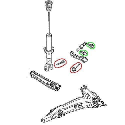

Old Mar 31, 2007 | 07:07 AM
  #40
Schimmel03's Avatar
Posts: 79
Default RE: my new stuff (UPDATE)
Ok, the bolts in green are easy to take out and the ones in red are going to be a PITA. Chances are you'll have to cut the one for the camber kit out but with enough heat, pb blaster, and more heatthe strut oneshould come loose. "SHOULD". I can't express enough how much heat and pb blaster will help. AND DON'T USE AN IMPACT!! It'll just round off the head. Use a breaker bar and the 14mm socket. Here:
