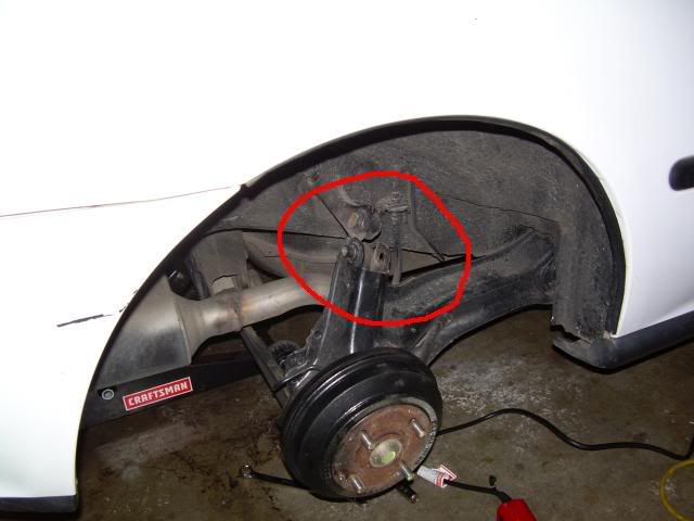

im out of ideas...ive been working on it for over 2 hours and cant even get the stock shock out. there is a TON of pressure pushing up and i dont know what to do. i have all the bolts out and all i need to do is just get the shock over the lca and come out....

the back...there is soo much pressure pushing up that i cant get the shock off. ive tried pushing down, jacking up, etc etc etc....been working on it nearly 3 hours now and still havent got it off. what in the **** do i do? i thought about taking the lower control arm bolt off but if that has any pressure on it, then i really dont want to do that. i give up for today.

Default RE: my new stuff (UPDATE)
ok i see what you mean on this pic is what i had to do to get some room to pull the strut out.but i don't know if your civic is the same mines a 1992

To get your strut out, you need to take the bolt that hold your Lower control arm to the body off. Then that'll drop down and you can push the trailing arm and all down and it'll slide off.
This is what i did as well.

so take the bolt off that holds the tie bar on ( if you have one which i do...) in the near middle of the car right? and this will just drop down and there is no trouble getting it realigned right? i dont want this thing to have 200lbs of pressure on it when i take the bolt off....

yeah, take one of the other 2 LCA bolts out. You won't get it out otherwise!
Peg's idea would work too, you're replacing that part anyway!!
