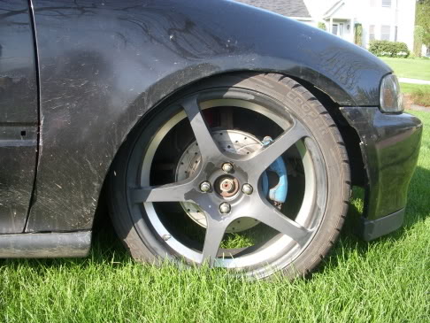

^^^ Take that fender liner completely out and roll the front fenders by hand (I mean literally by hand. It takes nothing to bend the inner fender lip up in the front) and you'll be in business.

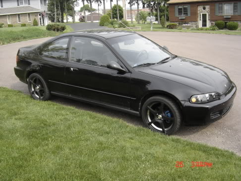

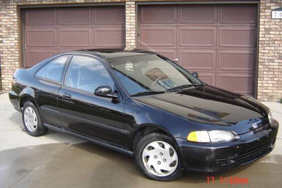

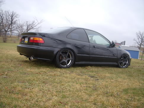

Stock height with 14's:
Stock height with 17's:

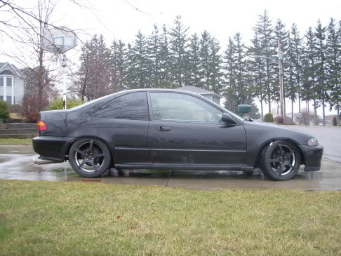

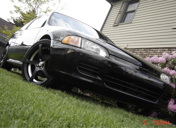

Ground Control coilovers and KYB AGX struts (between 3" and 3.5" in front and 3.5" and 4" in back):
*edit: Crap. Now I want to get another civic so I can dump it again.
*edit 2: Scott, just noticed the setup you're running. Have you run into any leaking struts yet? I replaced two within a year and a third was starting to leak when I sold the car.

I'd like to add to the rolling fenders thing... the front fenders can quite literally be rolled by hand (or at least I did it with no problems on my EJ1). All you have to do is grab the fender lip in one spot with both hands (side by side) with your fingers resting on the part of the lip that's parallel to the ground (the part you're going to bend up) and make a fist. The fenders are thin enough metal that it takes very little effort to bend them.
Now with the car I posted earlier, the front wheels only rubbed around extremely tight (steering wheel full lock) slow turns when I hit a bump. That's the only time any of the tires rubbed, and even then they rubbed on the frame rail, not the fenders. That being said, my wheels had an extremely high offset (+45mm) and I had -3.0° of camber at all four corners to help the tires tuck, not to mention the rolled front fenders and nonexistent fender liners. And yes, ride quality decreased, but it actually had a lot to do with the 205/40-17 tires I had. When I got ready to sell the car, I kept it slammed and put the stock steelies back on it... I'd say ride quality was about 50% as comfortable as stock when the 17's were on it, and about 75-80% as comfortable as stock when the 14" steelies were back on the car.
