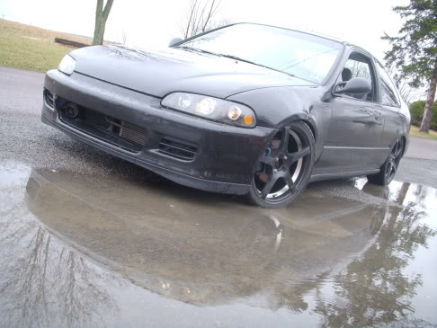

Okay, back on-topic. The bouncing means either your shocks are blown or they flat-out don't have enough damping power to cope with the drop. If the shocks are new, I'd say it's probably the second one. I had KYB AGX adjustable shocks; the warranty is void if you use them with a drop lower than 1.5", but hey... void warranties and blown shocks are the prices you have to pay if you wanna be a lowrider
Are the wheels 15x6? 15x7? What's the offset (it should be stamped on the back of one of the spokes)? I had 17x7's on my old civic and that **** was slammed... I had no rubbing problems. Basically, I'm saying if I can do this:
You should be able to fit 15's with no problems whatsoever.
