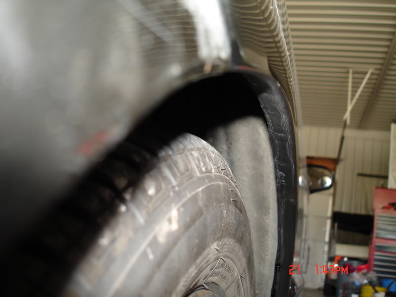

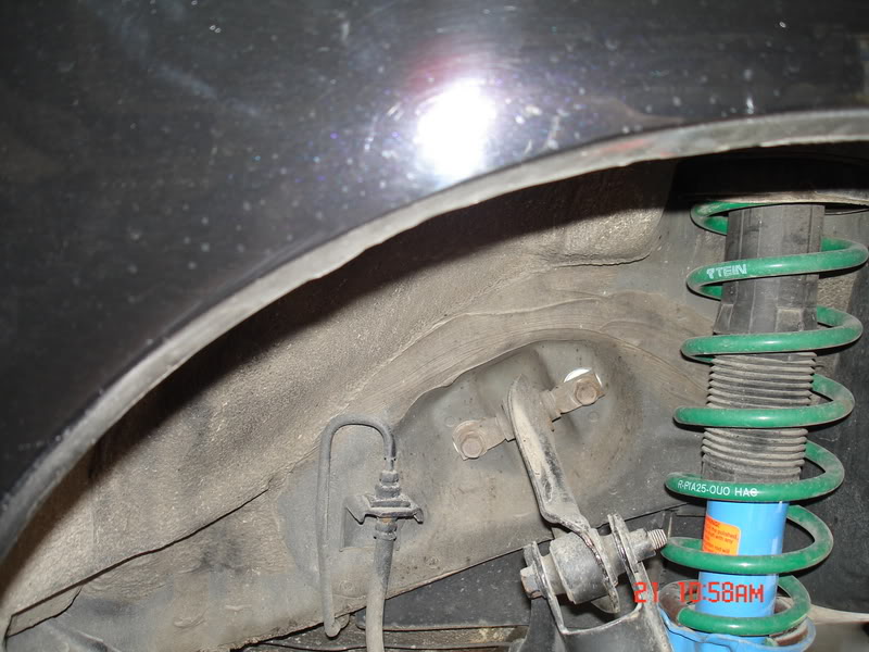

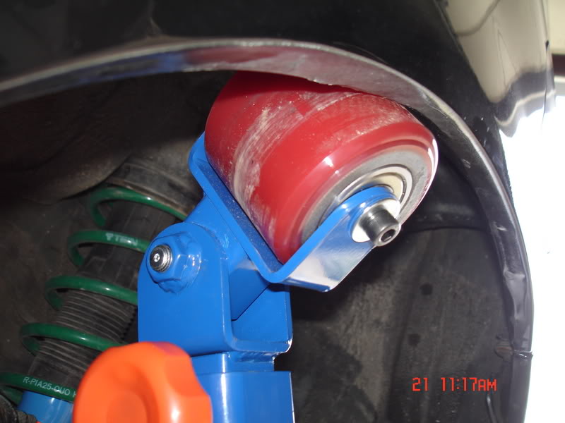

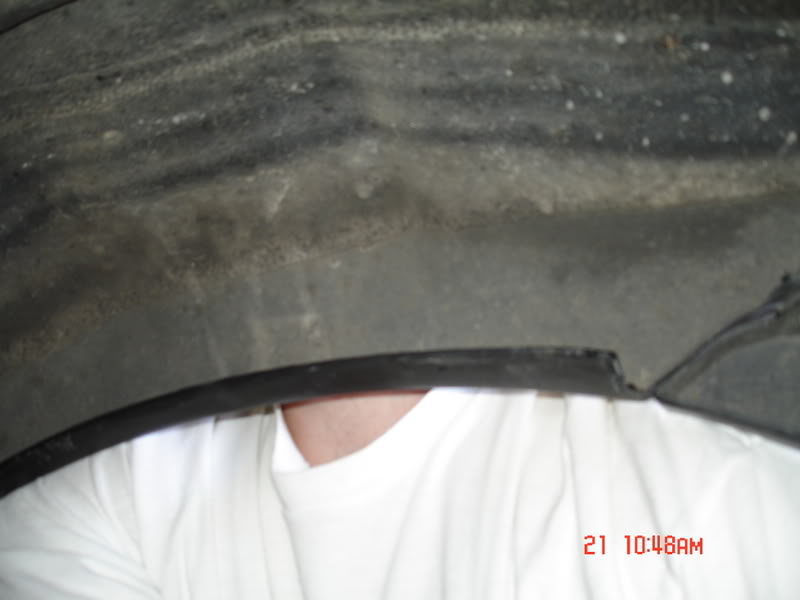

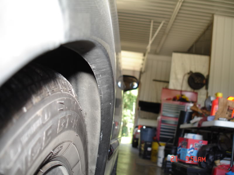

now i didnt roll mine alot.... infact i need to roll them even more with my lower drop to have proper camber.
you can roll the fender lip all the way flat if you want. just depends how much you want to roll...
typical offset is 40-45mm offset for 7inch wide rims those should tuck good for clearance.
as to tire size try to stick with as close to stock outter diameter as you can!
http://www.1010tires.com/TireSizeCalculator.asp
my 17inch wheels are 205-40-17
