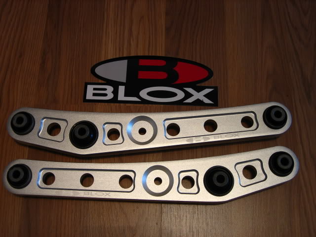

woot! finally..
what to do with the sticker...lol. i kno atleast 2 lcabolts ill have to torch out or break so i ordered them. wernt in stock at work but they should be here tomorrow. ill try my best to make a DIY, even tho its simple, but w/e i can do to help.

AJ, torching and cooling will not necessarily work. If possible, cut the bolt from the inside of the bracket. A cut-off wheel or a small blade sawzall might work.

im gena try to torch them first. if it dosnt work, ill just snap the heads of the bolt and snap the other side thats connected to the hub(which is just tack welded on). then replace that part with a new nut. if i break the heads off like that, ill be able to slide the arm out. i asked a couple guys at work about doing it and they said only way is to either torch it or brake the heads off.

yea...the one at the hub I had to brake the nut off...than tacked a new one there...

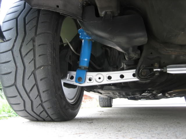

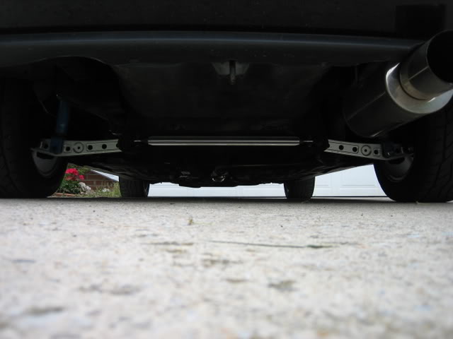

installed the lca's, for those who havnt seen already

i emailed Beaks company since they sell a quick-swap set(22mm sway bar, beaks srk, endlinks, etc..). they said that they are currently on backorder just like the other 5 websites i've emailed have said. BUT, if i order directly from Beaks, i'd get it faster than any other website. their price for the set is about the same or cheaper than most other sites anyways. i'll be placin the order tomorrowand hopefully everything will come in no later the May 18th.
