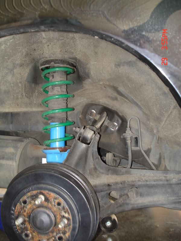

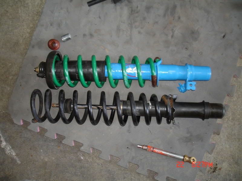

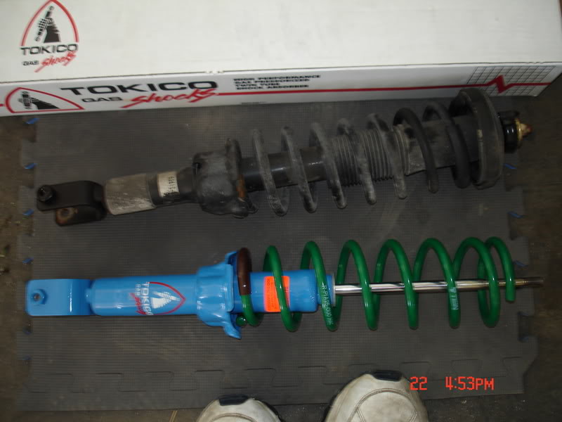

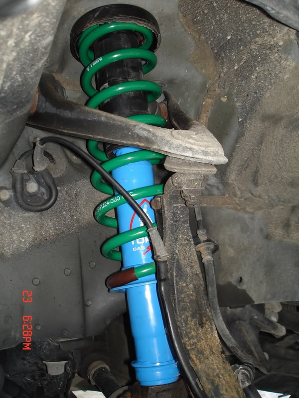

heres the only pics i have of mine

only pics i have left from my old install. hopefully you can match them up if no one else pops in and helps.

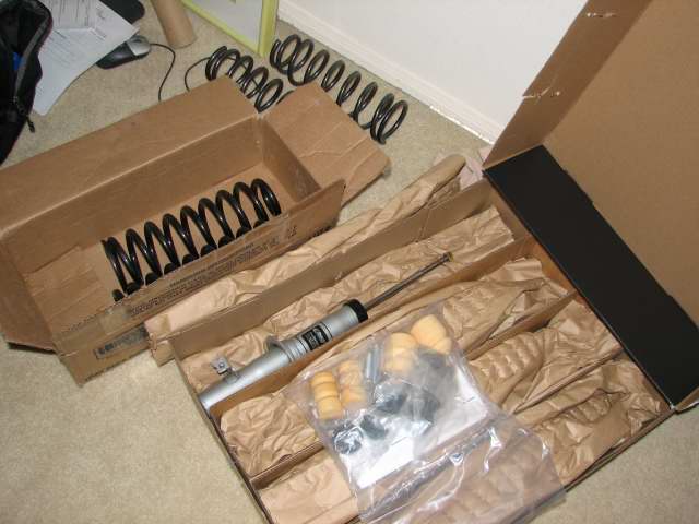

The thicker/stiffer springs go in the front since that's where most of the weight is concentrated. In this pic, the front springs are in the box. You can see that they are beefier than the ones in the back.

the F=front and R=rear should be labeled on the spring. from what i remember the longer ones goes in the back and the shorter ones go in the front
Old Apr 6, 2009 | 01:35 AM
^ o ya just noticed that in my pictures.... the first letter says F or R. hell i never noticed that before.
