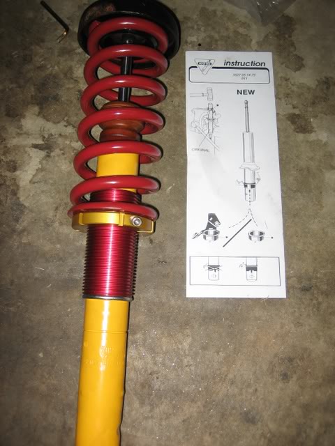

in a double wishbone suspension like ours, there is two basic components. a spring and shock. The spring is on top of the shock and held on by a top hat.
When you purchase a lowering spring, the spring is usually significantly shorter than the original OEM one. This poses a problem. When you jack up your car when you are on lowering spring, the spring wobbles when the car is on jackstands. If your springs are short enough and where you hit a bump to allow the car to lift up high enough even without the wheels lifting off the ground, there is a possibility that the spring will not SEAT properly since it can potentially wobble out of it's position.
A true coilover eliminates this problem. It's solution is to have an adjustable perch for the spring seat to allow it to always touch the bottom of the top hat and never wobble. To adjust height, the SHOCK itself's body is threaded and adjustable. The coilover shock is actually short stroke and much shorter than stock shocks allowing the body of the short shock to be adjustable in height. This way your spring will not wobble and you can still adjust height.

ORIGINAL: Fiirkan
I was gonna go with the Basics too, but i then discovered this, since they are basics, that's all they are just basics, spend the extra and get the SS, here's why...
that picture of me lifting the rear wheel up, the spring isnt in contact with the tophat and is probably wiggling around on the perch, its no big deal.
