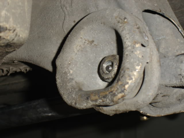

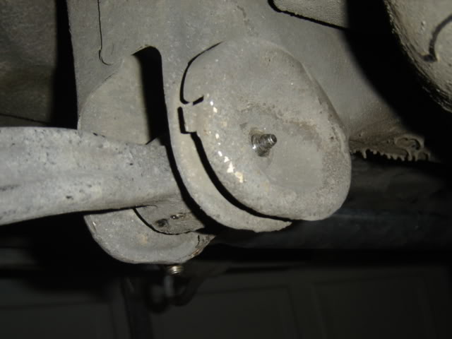

sorry i didnt specify. im talking about the rear lower bar
passenger side. went thru all the way just fine
drivers side. see it wont go all the way thru. can u notice the bend in the nut?

yup that looks crossthreaded-- just bust it off & get a new nut & bolt

i dont think that nut comes off its on the car forever. it like welded to the car. So u would have to get a thread restorer and rethread the nut and then buy a new bolt.

ill just take it to a shop and have them cut out the current peice and weld in a new nut
