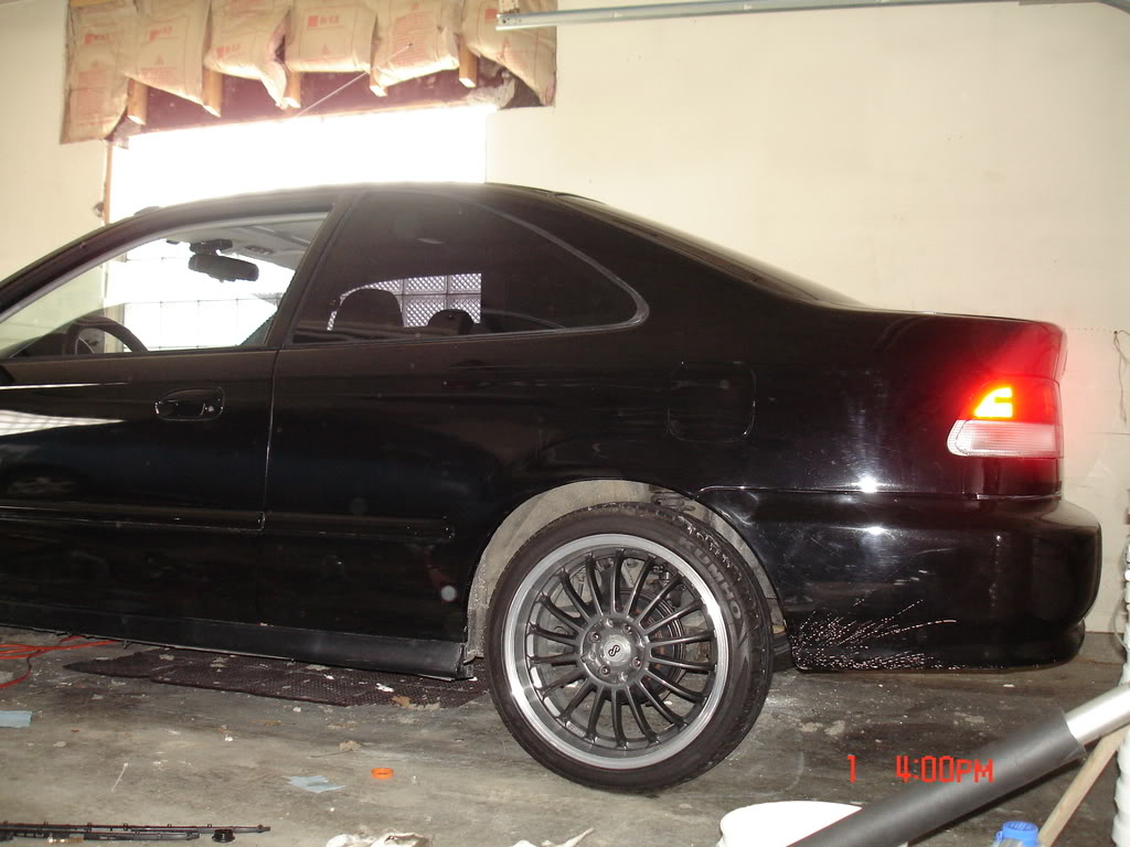

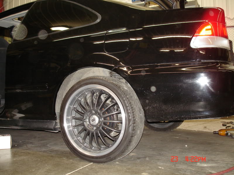

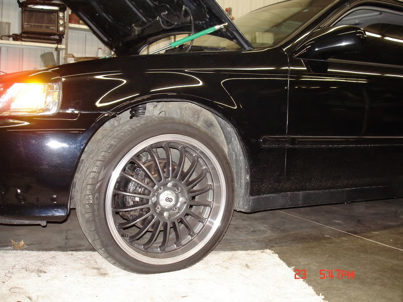

some pictures are in an attachment...pictures are from before I put the spring spacers in the rear which raised the rear about 1 in but still rubs
Old Apr 6, 2009 | 09:42 AM
looks like you car is lowered? maybe with cut stock springs? that is not a stock suspension setup, shouldn't look like that even with 16" rims, should look like a monster truck instead. maybe you should take another look springs. make sure its not stock springs that are cut, if so swap that out with lowering springs, or coilovers, or stock springs asap.

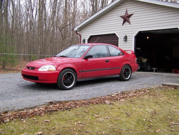

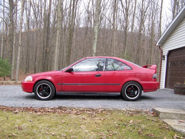

dito! defiantly modified suspension! with rims on stock suspension makes it look like a monster truck... heres my proof with my 205-40-17s
maybe the springs are cut or heated and thats why they bounce and rub so easily!
Old Apr 6, 2009 | 12:37 PM
improperly cut or heated springs would be my guess... either that or worn out springs and blown struts. There's no way those are stock springs in good condition.
