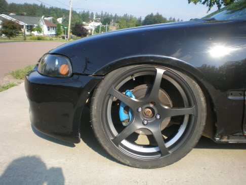

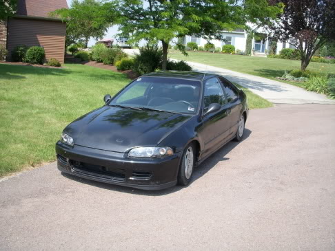

It's called +45mm offset wheels, no fender liners, rolled front fenders, and 3 degrees of negative camber. If you're like me, you already wash the wheel wells when you wash the car, so who cares if you get a little dirt in the wheel wells? Now go be annoying somewhere else.
To the OP, I'd recommend coilovers. They usually have higher spring rates than normal lowering springs, not to mention you can set your ride height exactly where you want it. Just make sure you get good struts or you'll blow them and bounce all over in no time. My suggestion (if you have the money) is Ground Control coilovers and KONI yellow struts. I have yet to hear a bad comment on that combo.

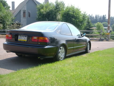

And remember, it ain't a drop until it looks like this:

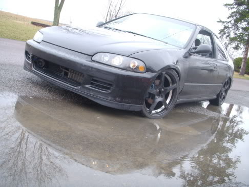

But speaking of negative camber.... as long as your toe is set back to factory specifications, you won't go through tires any faster unless you're running an incredibly soft compound. I ran 3* of negative camber on my civic... no premature tire wear whatsoever:

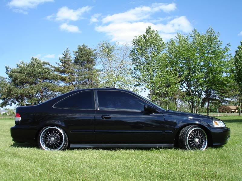

your car doesnt have to ride like a brick!
that was mine and wasnt to bad at all!
trust me you dont want the car to ride like a brick..... it will beat the hell out of you and youll be whining about it fast! youd be better off replacing the parts with stock parts! at least then the drive to the grocery store wont beat you to death!
