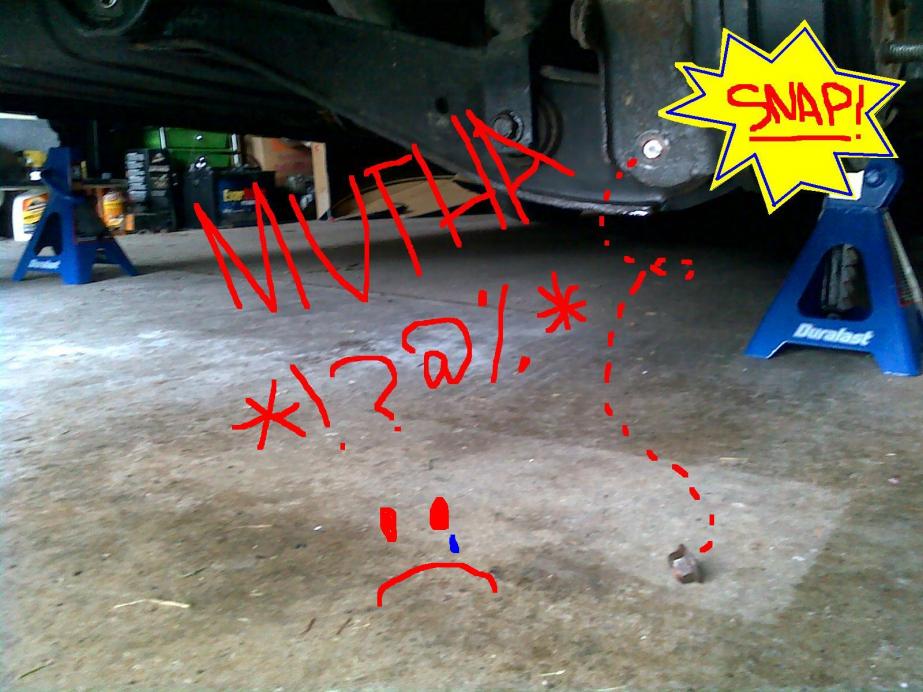

STEP 2: Once car is jacked up correctly and wheels removed. Use PB bolt loosen and spray on the 3 bolts that are going to be removed on the OEM LCA

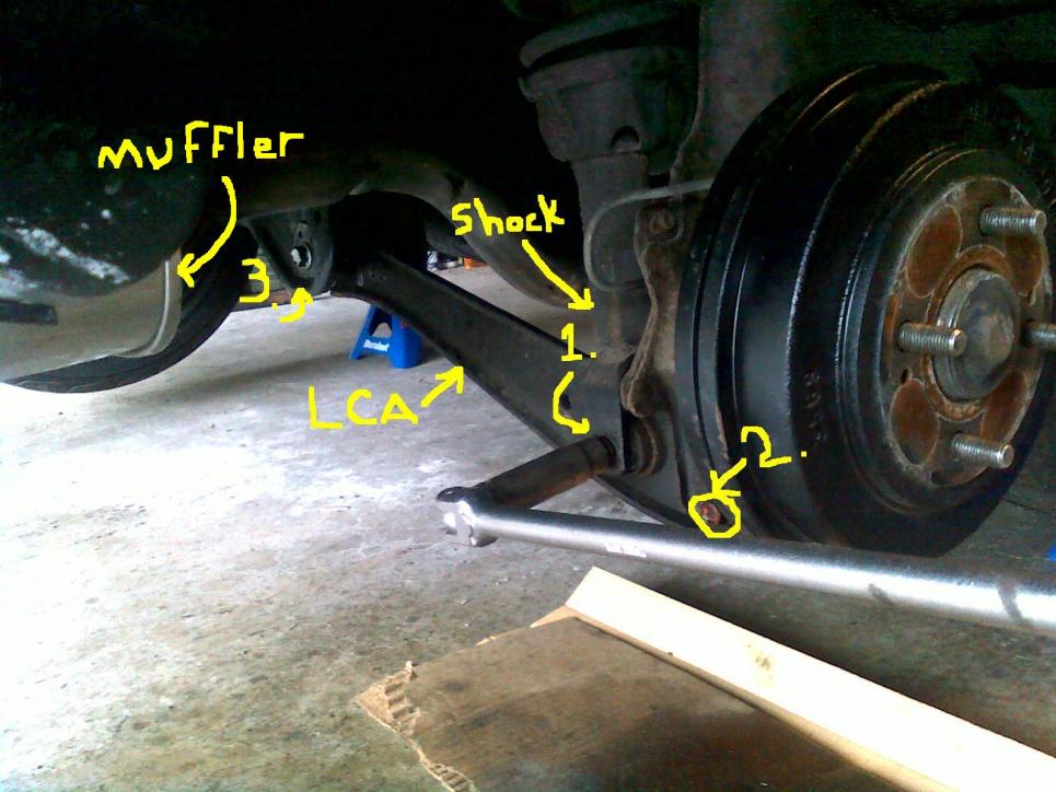

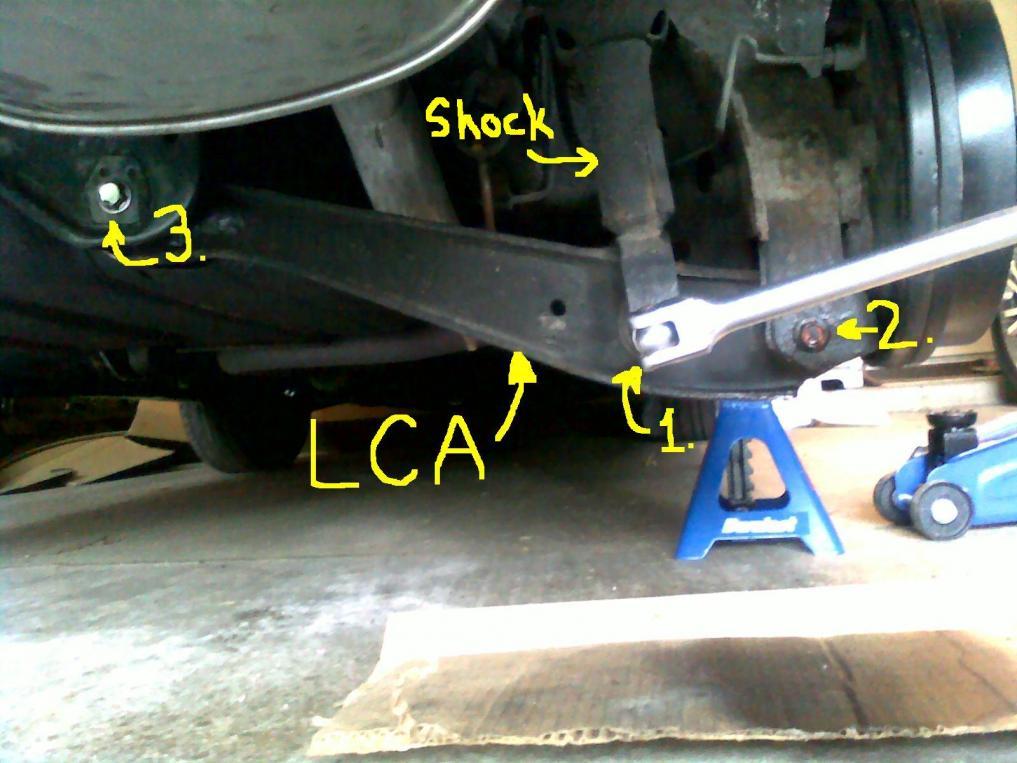

STEP 3:
Use breaker bar and extended 14mm socket to remove the 3 bolts in the order as pictured.

Look for thread to remove broken LCA bolts!!!! STUPID RUST

Btw no amount of penetrating lube will prevent a snapped bolt. It rusts into the bushing for good.

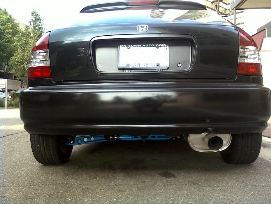

NOW i know. i had to take it to the shop and the mechanic had to grind and heat up the bolt to remove it. BUT!!!! they're installed now! YIPPEE!!
