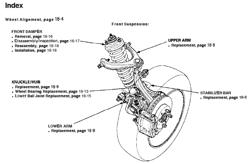

Some component of the front suspension is loose, disconnected, or broken. Lift the front end on jacks and carefully inspect. Grab and pull suspension parts with your hand looking for abnormal free play.
