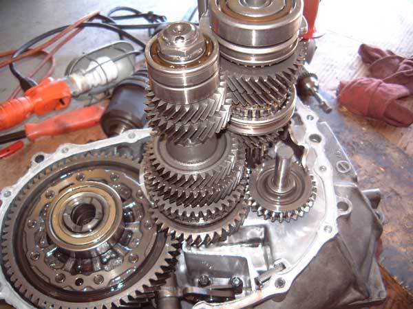

So I did a tear down while putting my other tranny work on hold as you see in below pix. Ireplace the syncros, syncros guide and gear.. take me about 1 hour from start to finish. As you can see in the pix below:
After casing off

3rd and 4th syncros guide, bottom syncros is for 3rd and upper is 4th gear.

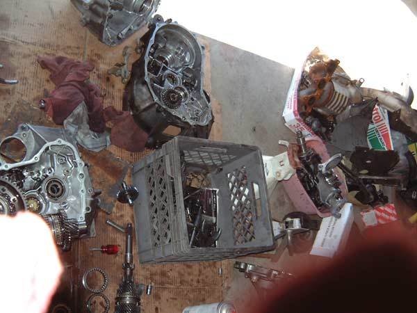

Currently working on another tranny.. and junk from other tranny tear down.

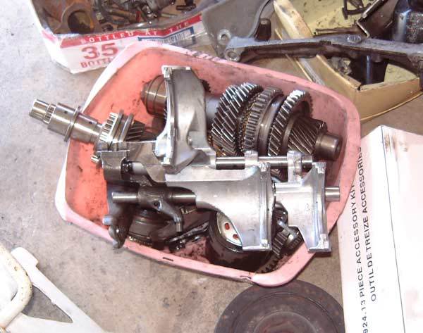

My pile of useful junk from other tranny. I'm glad I saved it..

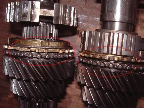

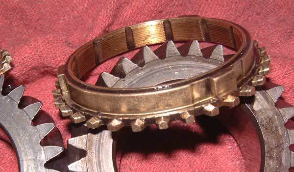

Left side is from the tranny.. right side is from my pile in the pink bin. You can tell the different in the syncros and gear.

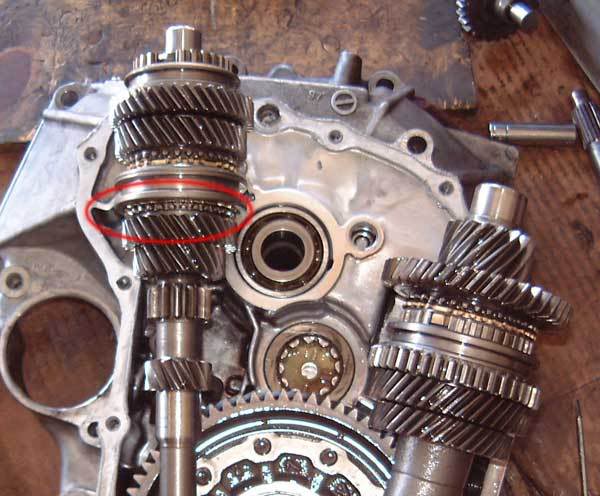

Removal of syncros for comparison.. GOOD syncros

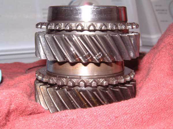

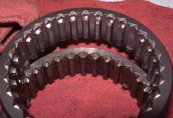

Syncros guide comparison. Notice the top is grind off.. compare to the good one on the bottom.
