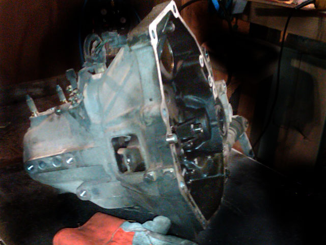

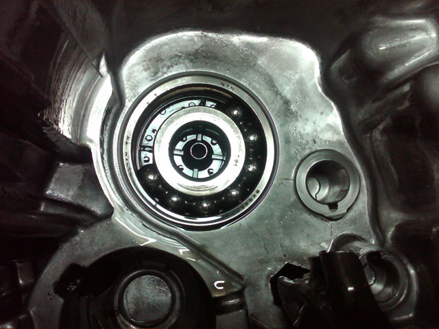

2.5 hours will get your transmission out.
another 10 minutes might reveal missing ***** in your counter-shaft rear bearing.
be careful what you do with your time.
Attached Thumbnails 5th gen 1.5 trans question-civictrans1.jpg   5th gen 1.5 trans question-civictrans2.jpg
