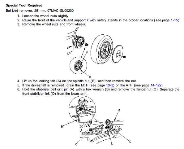

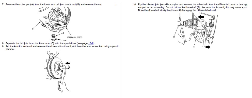

Just as a little recap, I finally got to change the drive shaft and wheel bearing on my girls 2002 civic. Thanks to RonJ it went all pretty smooth.
The first real issue was the lower ball joint. I went to Murrays to get the ball joint puller Honda recommends in there manual. Well I got a whole front end tool kit from them as a loaner. However it was really hard to get that joint breaking loose. I did put a nut on the end of the joint as explained in the manual but with all the force I had to put on I damaged the whole thread by bending the nut. So I had to install a new ball joint as well. The pitman tool works much better if you know were to place it. I know now! LOL Pressing the hub out of the knuckle was a challenge too and ended with a big bang as the inner race broke loose as it's supposed to. Pressing the new bearing in was pretty simple but you have to make sure your holding against it in the right spot!! Guess how I know...
I bought a new bearing......go figure.
Putting everything back together was not a problem but getting the new drive shaft in the tranny case was not as easy as it sounded. took me a while to get the snap ring were it belongs.
Rather then that it went all well and the ugly noise is gone
Its running great now.
Thanks again RonJ for your help!
