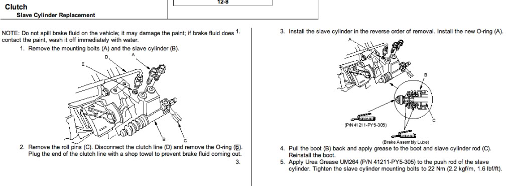

As shown in the diagram, immerse the bleed hose into a container of brake fluid and then slowly pump the pedal. When you get a steady stream of fluid (no air) continuously rather than "here and there", then hold the pedal down and tighten the bleed screw. If you don't completely immerse the end of the hose in fluid, you will draw air back into the system when the pedal goes back up.

Did you install new O-rings on the slave and master cylinders? Did you properly tighten the hydraulic line connections?
