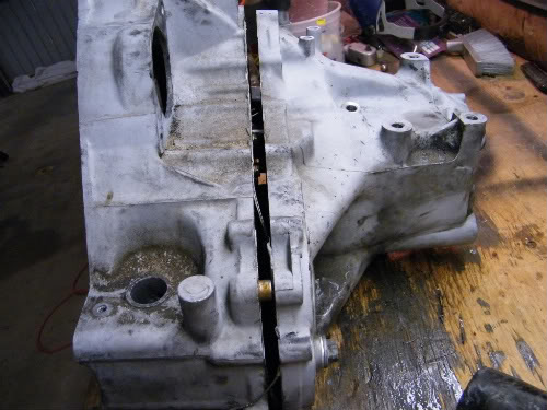

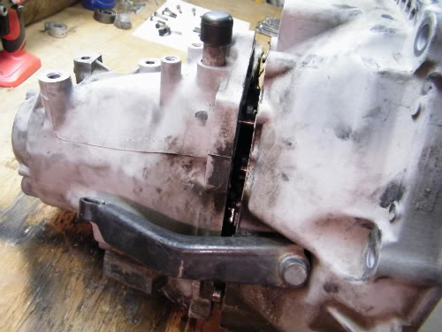

Well, I dropped the tranny and it doesn't look good.
I guess my next question is, is there a snap ring somewhere on the drive shaft under the throwout bearing? I can't seem to get the housing off. I can get it half and inch and then it won't go any further.

Looks like this may be an easy fix. I guess my question is, "What the heck do you call the rod going through the center of the diff. The allen set screw broke and that rod slid out the side of the diff and broke some casing ribs(all the metal I found) and then got far enough out that it got stuck between larger parts of the casing. The rod is bent a little bit but I might be able to fix that unless it is cheap and easily accessable.
