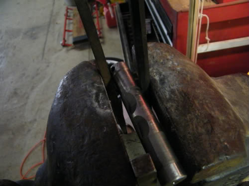

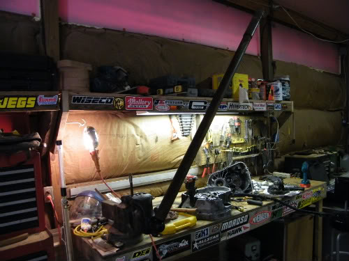

Well, I straightened the pin(I know it's not the best thing to do but I am broke and need to get back on the road) It is a strong little sucker and is VERY close to straight. I don't know if you could ever get it perfect. I placed three pieces of steel in the right places in my vise and went to work with a 6 foot bar extension.

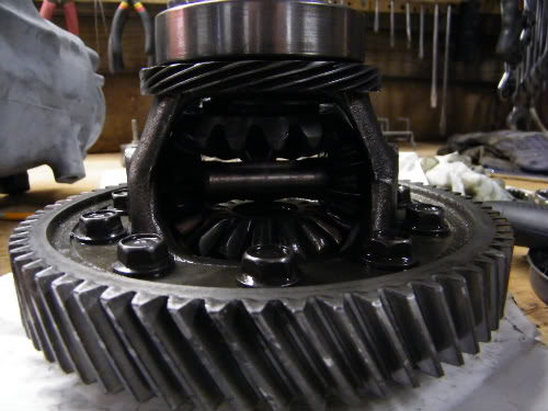

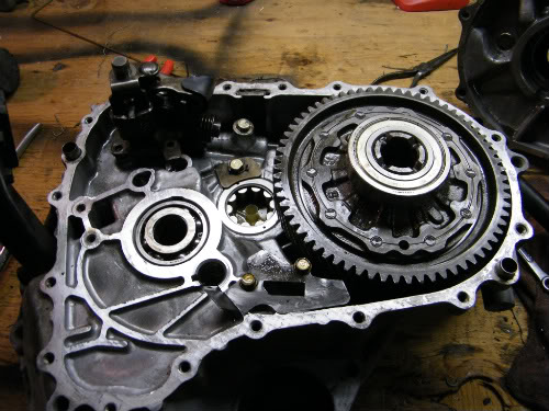

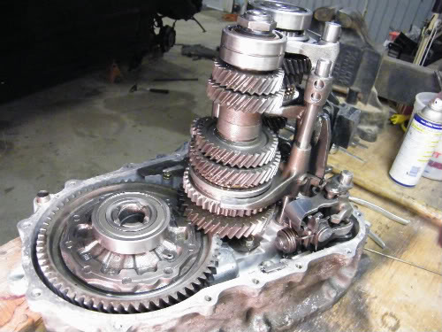

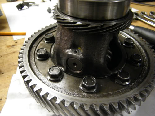

Got the old roll pin out and drilled it out of the bottom of the diff and installed the new one. Put the diff back in and the gear towers. Now I'm waiting for the RTV to dry so I can finish tightening the housing bolts and get this thing back in.
