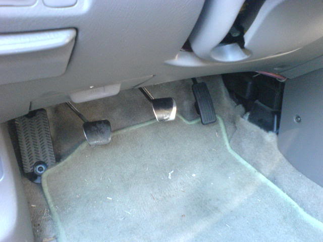

Alright! as a Christmas present (to myself), I got some work done today.
I got the pedals and master cylinder/clutch reservoir done, pics below:

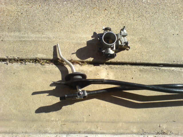

Here's the shift linkage with s2 dual bend installed and the new throttle body:

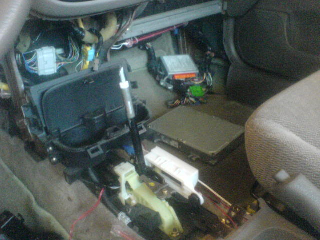

Last night I pulled the center console, driver seat, auto ECU, air intake, and did a couple other things to prepare.
Everything is pretty much ready to go
It is now 10:30am, and a few people are coming over to help do the bulk of the work.
stay tuned!

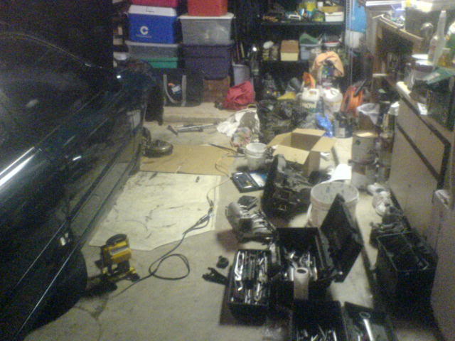

bunch of stuff layed out in the garage--expect a mess if you're doing this swap!

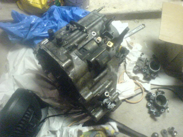

Good riddance huge auto tranny!

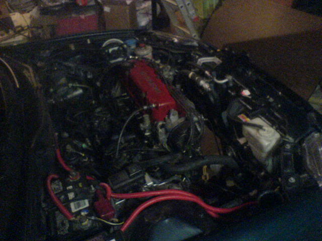

somewhat empty bay

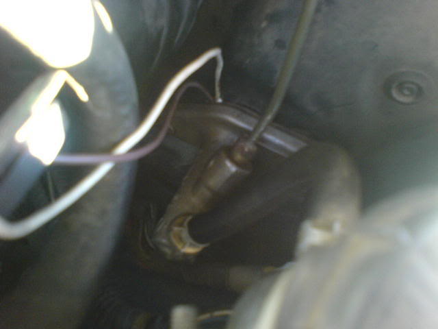

you can see the shifter and ECU--shifter is now completely out, didnt take a pic yet though

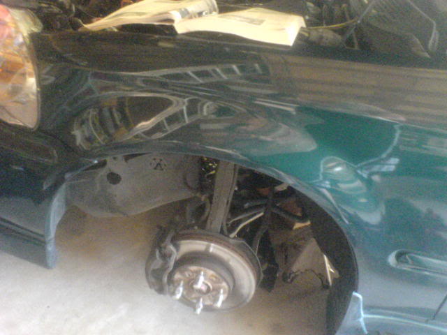

random pic

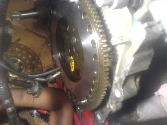

flywheel going on
Old Jan 1, 2008 | 05:32 AM
Default RE: Oblig's EK Auto to Manual Conversion [12/31:project underway!]
about to say.... shouldnt thier be a bearing on the flywheel? doesnt look like you put it on thier...
