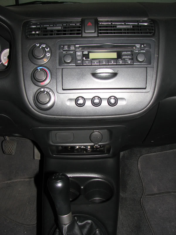

I just picked up an '02 Si, the Canadian version, and I was hoping some of you here could detail how I go about starting to remove the factory deck. I've tried researching a bit, but I'm reading different suggestions on how to go about it, so I thought I'd take a pic and let you look and tell me if you've done it before.
Here is what I have now:

You have to take out the center console, then under the climate control there is two 10mm bolts that have to be removed, then you should be able to pop out the climate control and stereo, to remove and replace the headunit, you will need an adapter most likely

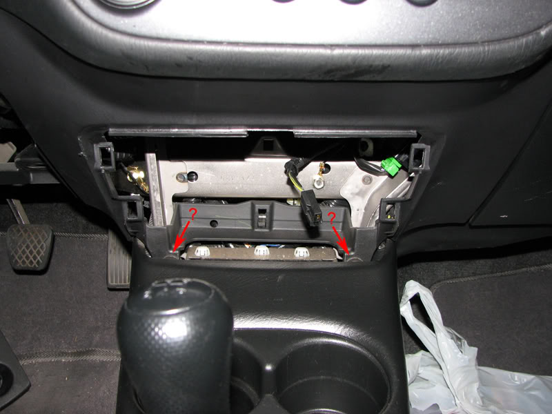

I popped out that lower middle piece with the power port, but I didn't see any way to get the deck out from there. I saw two bolts down low, but I'd need to take the center console out to really get at them. Is that what you were talking about?
Once I have undone the two bolts, does the whole climate/stereo piece just pull out, or does it need prying or tabs to be unclipped or anything?
