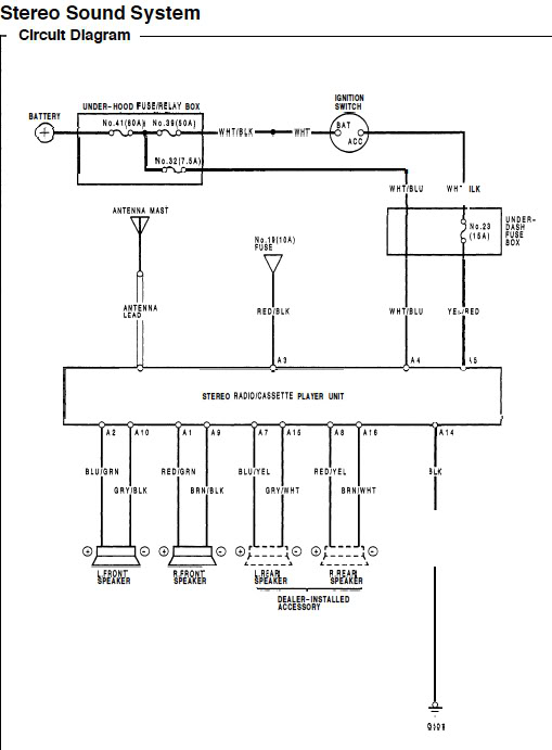

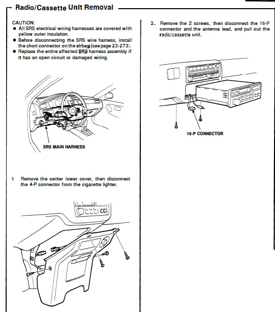

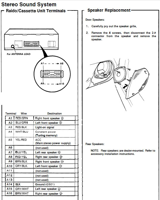

ron, that looks magnificent.
I found an installation manual, it's not very descriptive, but it shouldn't be a tough job.
The problem is, I think it's been ghetto-rigged, which makes it tough
I can't get the casing out of the dash, it won't fit, but it slides around like crazy. I'll just try and find some more screws and just have at it.
thanks, I'll repost or bump if I need more help
Ok, so what is the cable called with the 16 terminals?
I have 2 slots in the back of my radio...well, I guess 4, but.
I have the antenna port
The port for the thing with the 16 terminals (whatever that's called)
And a red and...yellow or white output it looks like, they weren't being used.
I decided I'm gonna try and buy a new cable that has all those 16 wires before I go for a new radio.
It's driving me insane.
The 16 wire plug fits a stock radio. Aftermarket suppliers make a 16 wire socket that fits that plug, because the plugs on aftermarket radios are all different.
The proper way to install an aftermarket radio is to buy the socket and splice it to the wires on the plug supplied with the radio (which fits the radio). This is done at the comfort of a work table indoors, rather than out in the car. Then go to the car, remove the stock radio, plug the 16 wire plug to the new socket, and the new radio is hooked up.
If someone cut the stock plug out of your car doing a ghetto install, you can cut one out of a junked car and splice the wires to the wires in your car, so now your car is back ready for a stock radio or an aftermarket one done with the adapter plug. Always disconnect the battery before working on the wiring in the car.
