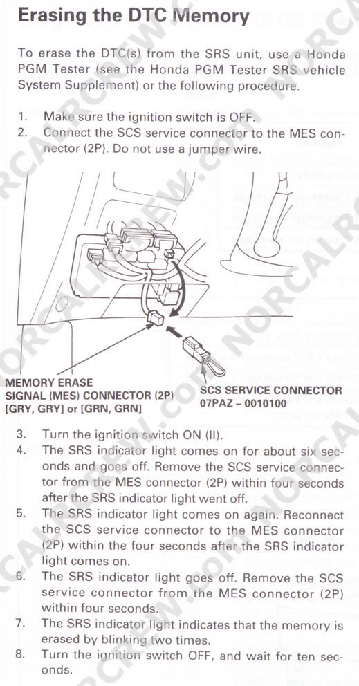

You can use just a paper clip to make the connection.

hmmm ty will give it a try

when using this method its pretty much a necessety to turn off the stereo, amp,and anything else that draws a lot of power, otherwise you'll spend all day trying unsuccessfully.( i found out the hard way).
