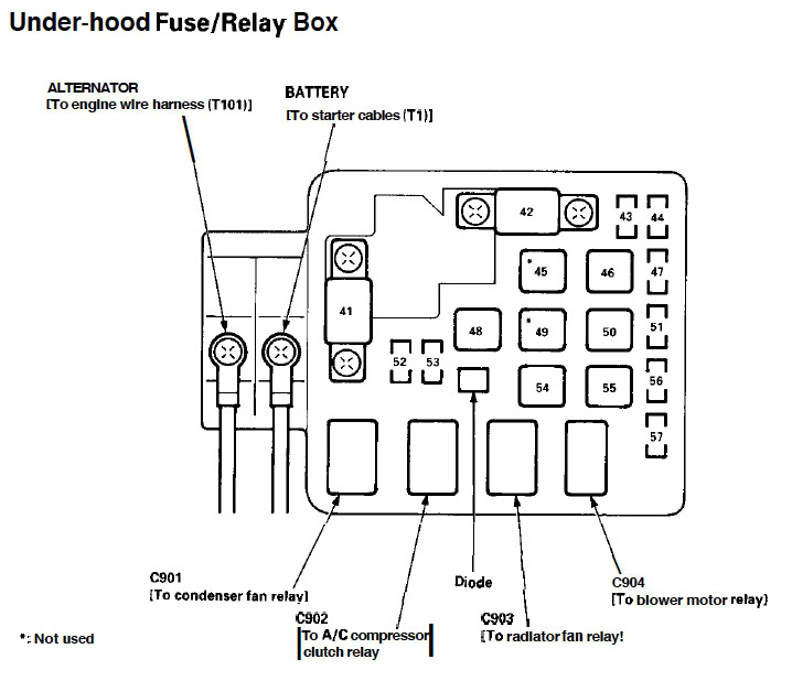

Check whether fuse 43 under the hood is blown (see diagram). When the key is turned to ON (II), does the CEL turn ON for 2 seconds and then turn OFF?

thanks for the quick responsesand i agree... the pic and the diagram are both most excellent. the engine is a b16a and fuse 43 is not blown. and yes, when i turn the key over the CEL comes on for 2 secs and then goes off. any more ideas would be greatly appreciated. i am quite the novice at civic tuning. thanks again.
