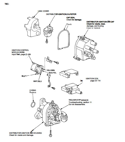

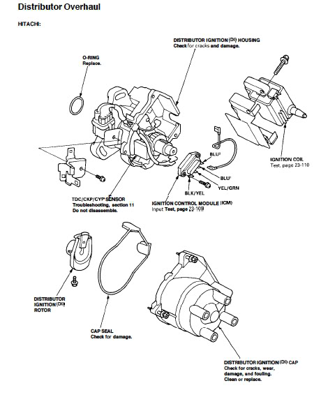

Call additional auto parts store about bench testing your ICM. Do you have a 96-00 Civic?
You can determine whether the timing belt snapped by removing the oil fill cap and looking under the valve cover with a flashlight to see whether the cam turns while a buddy cranks the engine.
To access the ICM, you need to remove the rotor. The diagrams may help:
