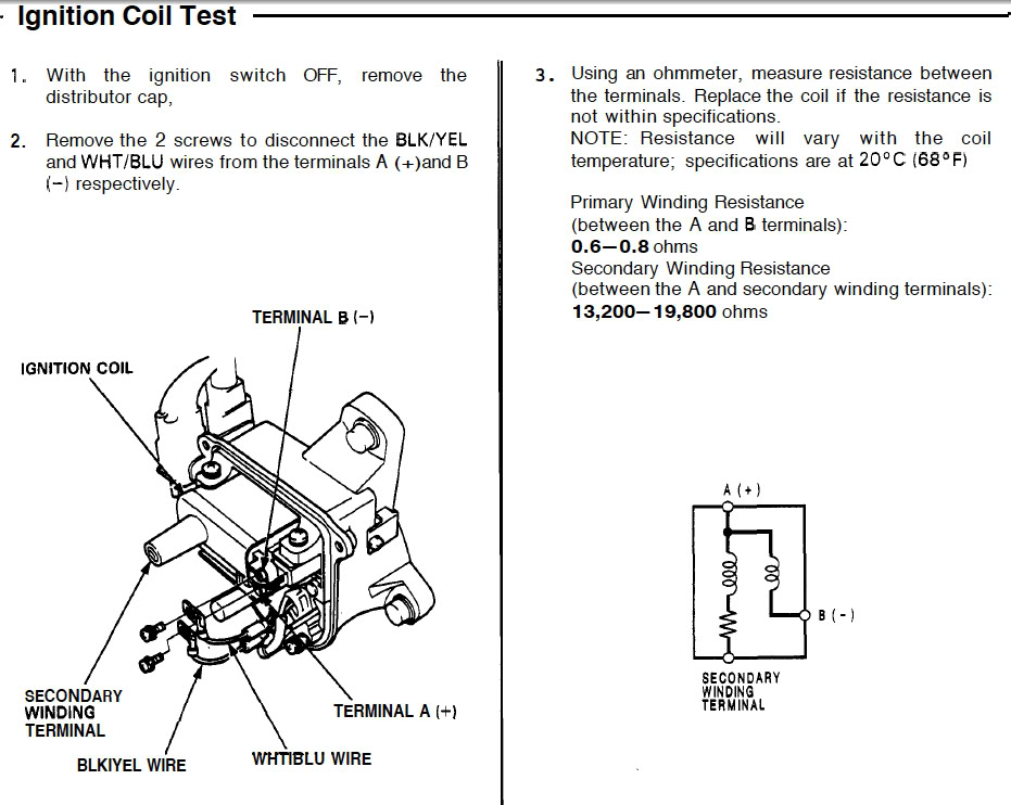

Your distributor has an ignition coil and an igniter unit/ignition control module (ICM). Running the engine without a plug wire connected would most likely blow the coil. You can test the resistance of the coil to verify:

Hmm, I thought it was the same thing. So much for trying to be smart. lol
Anyway, what I asked for at the counter was the ignition coil. I went outside and installed it and said screw the test and it worked. In fact, it starts stronger than ever.
Thanks for the diagram RonJ.
