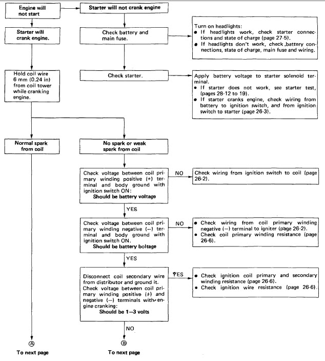

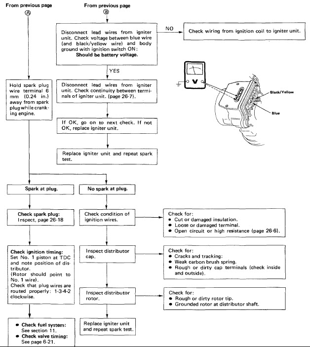

I'd double check all the wiring and connections inside the distributor. Also, have you done the coil tests shown below? If all seems fine, then you may want to check whether the timing belt snapped.

i would also look into maybe replacing the ignition control module...i've had them go bad and the same problems happen to me.
also know as the ignitor

I've had problems with the ignitors also. The cars would run fine when it's cold, as soon as it hits a certain temp it will shut down. Then restart after cool down again. It's located inside the distibutor, kinda buried but not really hard to get to.
