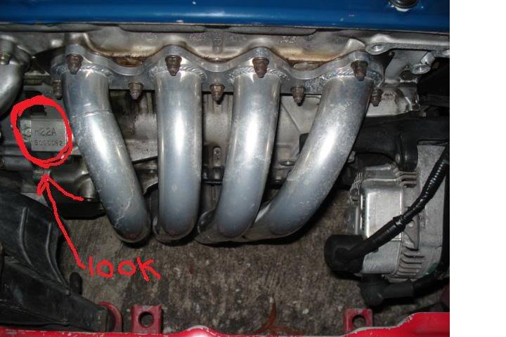

i have NO idea what engine it is, refering to ' d15b7,d16z6,d16y8,d16y7 ' and so forth. dont even know how to find that out?
